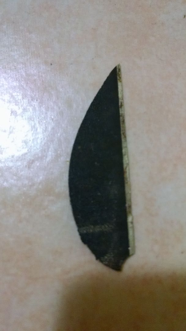

I also found a piece of the blade directly under the branch I was lopping off brought it in for a pic
I'll email kbar now and send pics, I'll keep you all posted

Hey MadIndian.....
Thanks for the kind words........ Your latest pic shows what appears to be a long dead pine...... Not sure about this but the appearance of the bark, the large annual rings and solid core make me pretty sure..... If my guess is correct then the area close to the trunk and at the point the branch formed in the tree will be quite resinous and can be hard as a freaking rock, especially if frozen.......
Those intersections are "pine knots' which are great for starting fires and are best harvested with a large club..... The joins are frequently almost solid, fiber reinforced pitch....... If the club breaks the limb outboard of the join try another until you get the hang of it........ When the main trunk is damn close to rotted away is the best time to do this harvesting..... Those pine and hemlock knots are way harder than hard wood.........
Give the fresh cut a sniff and see if it is pine...... If you can get a lengthwise cross section with a saw and study it a bit.....If I am right, you should be able to scrape some really resinous stuff off of it and it will make a great receptor for a ferro rod strike....

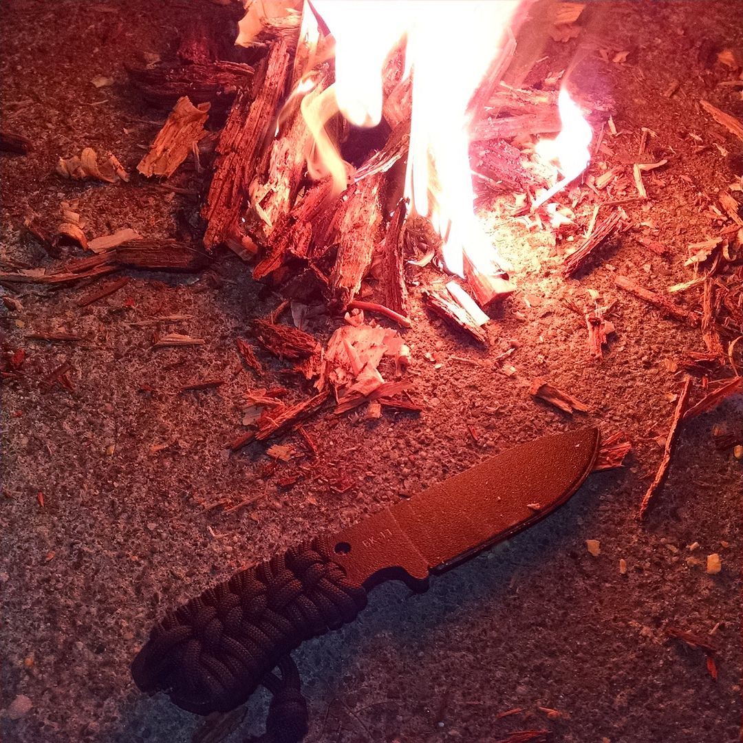

I'll try to get those pine knots, its definitely pine just not sure what type it was, guess I missed that word typing too fast :D . and another lesson thank you.
I grabbed some wood that fell from being chopped, rotted or otherwise made some shavings and split some stuff down with the bk11 and firesteel was all I needed
and now I know not to do that again :-)
