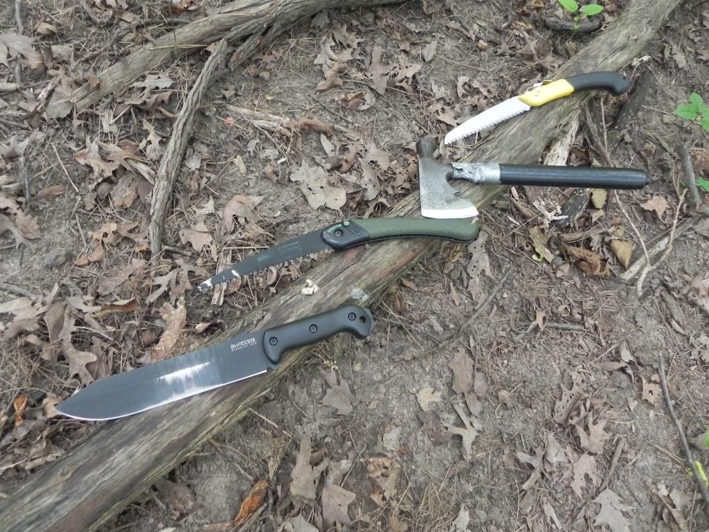

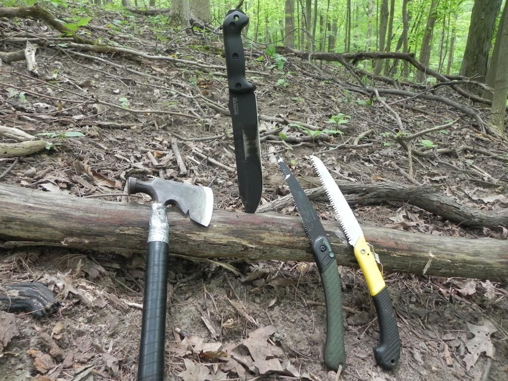

We all know that the BK9 is an incredible chopper.....when compared to other knives. Aside from the added awesome factor of the knife (and versatility), I wanted to see how it stacked up against it's primary competitors in the backpacking wood processing realm: the camp hatchet and the folding saw. For this test, I used a Bahco Laplander to represent a "quality" folding saw, and a Stanley saw to represent what you can just pick up at the hardware store for $5-$10. The hatchet is also of the run of the mill hardware store quality (I think it's also a Stanley).
For this test, I chose a decent sized, recently-fallen tree. I would estimate the diameter to be 4". I timed how long it took me to get through the tree with each tool, and counted the number of strikes for the BK9 and hatchet. I also made a mental note of how tired I was after each use. I wasn't trying to chop/saw quickly, just at a consistent pace.
The competitors

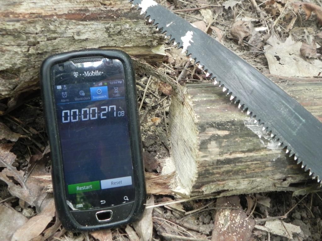

Contestant #1: Bahco Laplander
As expected, the Bahco sailed right through it at a time of 27 seconds. I wasn't tired at all, and at no time did I have to use both hands on the saw

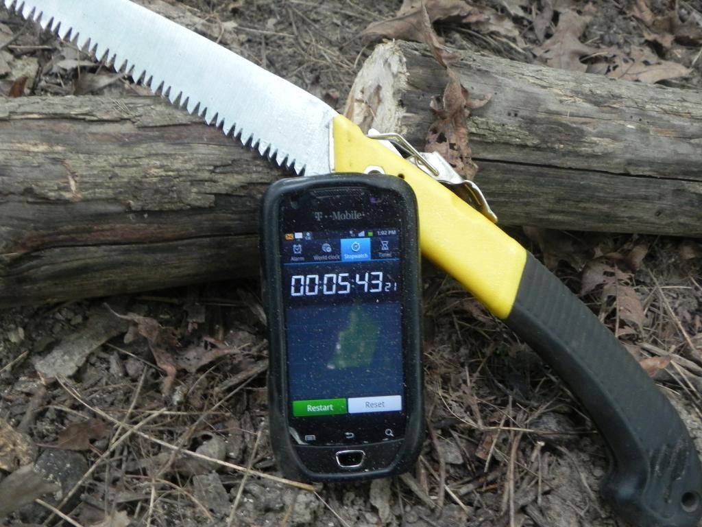

Contestant #2: Stanley Saw
This one was a bit of a surprise. I didn't expect it to go as fast as the Laplander, but this was ridiculous! It took everything I had to get through this log without passing out; the blade kept getting stuck and wouldn't stay straight. 5 minutes and 43 seconds....wow
Notice the difference in the design of the saw teeth, which I assume accounts for the disparity in performance

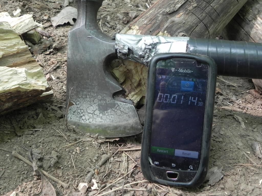

Contestant #3: Camp Hatchet
Solid performer, total time of 1 minute 14 seconds and 41 chops.

I don't think it was the design of the teeth that made that saw so poor. I'm going by memory as I'm at work but the geometry of those teeth are very close to silky. So I'm thinking it's something else. It was either duller, or it didn't cut a kerf. Both things would slow you down. Dull is pretty easy to tell but are the teeth on that saw offset at all? Or is the spine thinner than the teeth? This is the two methods(that I know of) on how to get a saw to cut a kerf. The laplander has offset teeth about every inch or so. The silky has a thinned out spine.
