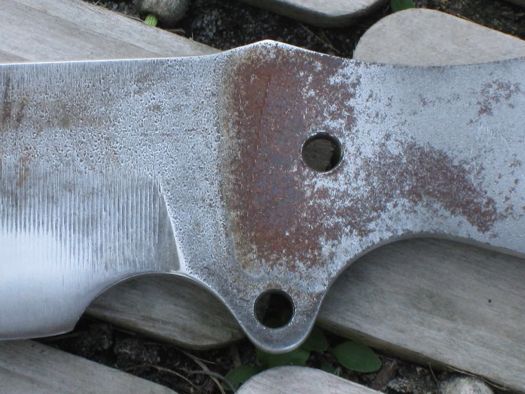

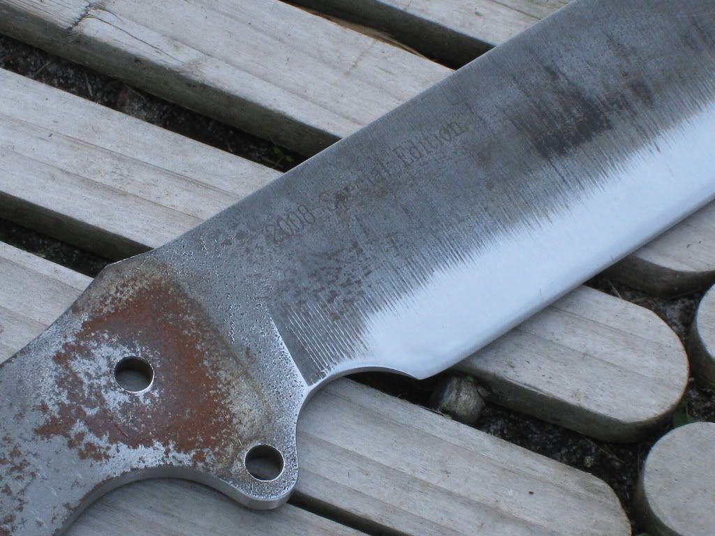

I don't know... But, I got rust!:
And this INFI rusted easily. This is not from being left outside in rain or dew.
This knife grew this rust inside my house in a drawer.....
Granted: This happened after hurricane Ike hit Houston and I was without electricity (No A/C) and with Houston's high humidity (especially at night). But, still, this rust happened a couple of months ago while the knife was safe and sound in my house in a drawer. And I would estimate it happened in only about a week or two's period of time.

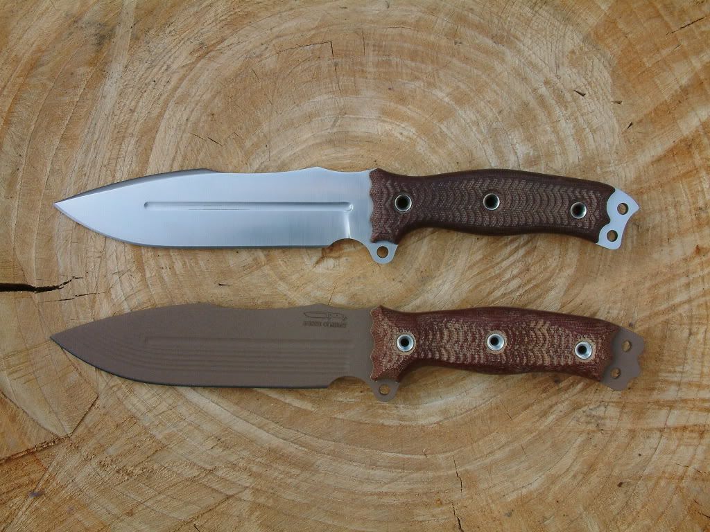

I was actually suprised at how easily it came off of my NMFBM after I stripped the coating off. All it took was a little sanding. I started smiling 10 seconds into the sanding.
This is the finished product after BeadBlasting.

As it is, you can confirm in the pictures, most of the rust is actually NOT in the pits - although some is. Most of the rust is at the "Machined" parts of the blade: groove and false edge on top. The rust is primarily in the grooves and false edge on both sides. There is some rust in the pits. But, 85% - 90% in the "Machined" areas. The false edge on top of my HR appears (clearly) to be cut by machine and not sanding belts. There are obvious machine marks on the false edge.
The blade's edge, choil, flat part of the spine and the exposed tang areas of the handle were obviously sanded after the handle was attached and there are no significant signs of rust in any of the areas that were sanded. So, whatever was on the steel prior to sharpening and handle finishing, stayed on the steel except where sharpened.

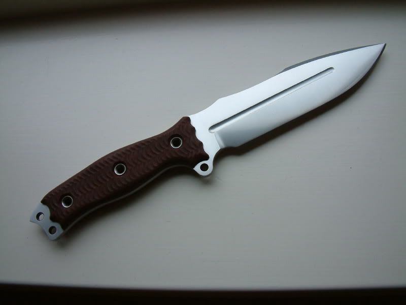

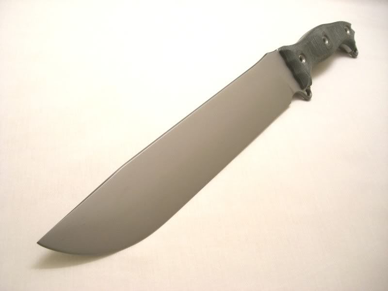

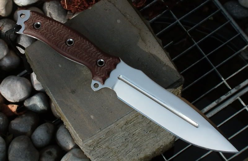

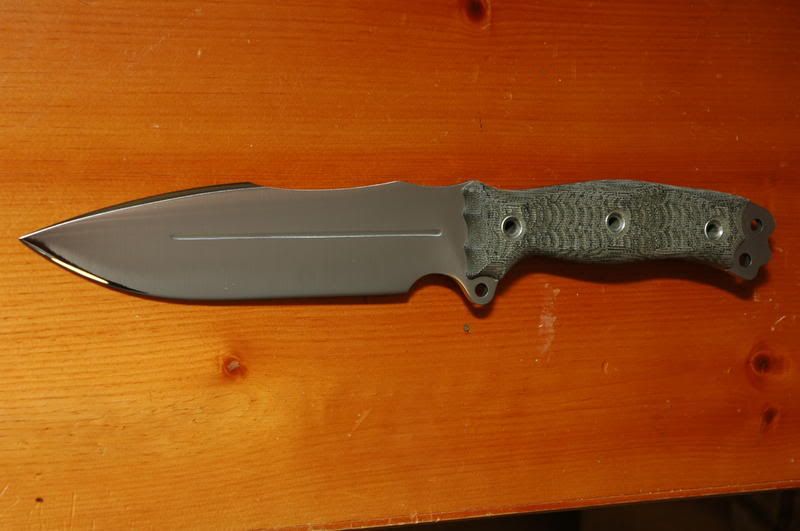

However, I "DO" prefer satin and having seen the Satinized Mud Razors (following pics "Borrowed"), I may not be able to resist doing a full treatment (wish it came this way.......):

I'm not a metals expert but this is what I think is going on. When carbon steel receives its heat treatment there is a very thin layer of the steel that loses its carbon, the "decarb" layer. This thin layer is much softer and very prone to rust. This decarb layer happens to all Infi during the heat treatment.
Generally Busse removes this decarb layer (satin or double cut) or covers it (coating) so you don't have the rust problem. With the Competition Finish blades the decarb was not removed and was not coated so you end up with a rust-prone and exposed decarb layer. Note that the edge of the blade where you have the convex grind did not rust, that's because there is no decarb layer there... it was ground off. On your Hellrazor there is more rust in the creases because that's where most of the decarb remains.
There is not a layer of a different metal, but the "decarb-Infi" is what you see rusting. Remove that layer and you will be back to the rust-resistant "normal carbon" Infi that we all love.
Hope this makes sense. :cool:
OK....to protect my blades.... the new ones, should I buy only LE or DC models? And or sending them to someone like Ban to have them stripped if they are coated with anything else....will that protect them? I'm still a bit confused about this whole decarb thing...
Here's the drill...
The satin finish blades (i.e. LE, customs, and some regular offerings like the BAD and GW) are very rust resistant as the decarb has been removed.
The double cut is almost as good as the satin but the double cut process leaves more pores for moisture so they are less rust resistant. These should also be decarb free.
With coated blades the edge is effectively satin so again, no problem with them as the coating prevents rust.
Uncoated/stripped blades may or may not have decarb. Exposed decarb is the problem. From what I have seen all of the Competition Finish blades have some decarb on them. If you strip the coating off of a knife and the metal has a black tint then you have soft decarb you need to remove with sandpaper if you don't want rust.
