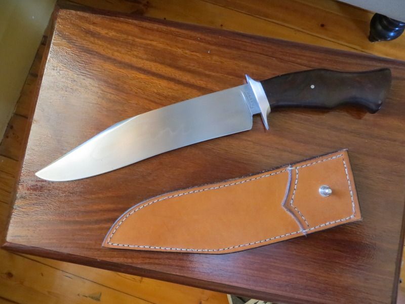

here are a few pictures of my knives atm.
First Few forged and ready to grind
Lookin a little more knifey
Into the oven for normalization and grain refinement
Rebel Fighter Recurve - Ht'd and blue tempered spine (52100)
Rebel Fighter Recurve First polish
Group of 5 knives initial polished
Continuing.......
Guards in the rough
After polishing up the big W2 bowie I just couldnt live with the way the Hamon dipped down at the Ricasso.....
So, being a proper insane Bladesmith I took the polished and finish ground blade, coated it in Turcoat (really great stuff btw) and threw it into the oven to redo the HT
MUCH better (quick 180 disc polish and etch to make sure)

Correct me if I am wrong, please. However, my limited knowledge of ABS stuff indicates that most people use 5160 or maybe now 80CrV2 or L6 for the bend test. Is that right? Outstanding that you got it with W2 (did you clay that blade?).
great step forward, with many more to come. Good to see your work again.
kc
I, too, wondered what had happened to you. Glad to see you back.
kc
Kevin,
Your absolutely correct, most testers and most MS suggest using 5160 because it's consistently performed well in that test.
however, had I made that blade from 5160 it would have been my 3rd time EVER using that steel, whereas I've used Don Hanson's W2 for about 8 years and hundreds of knives.
I felt I had a better knowledge of that steel than I would have with 5160 ;-)
it performed exactly as I wanted it to.
