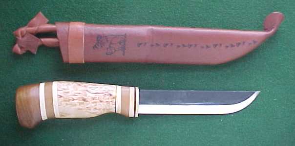

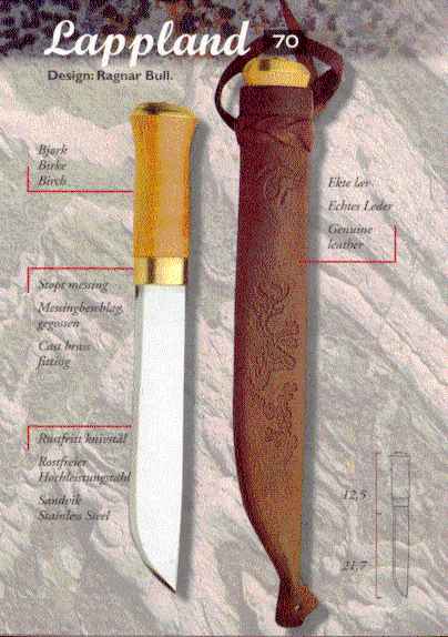

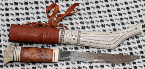

Are there any traditional Scandinavian knives as big as a Bowie? Bowies have plenty of edge length, I don't think the choil brings it below optimal functional edge length. Designed as a fighting knife the length to the tip is important and the choil does not diminish this while bringing a little versatility in usage. Seems like a good idea to me. If I was an old time frontiersman and it was the only knife I carried it would seem like a great idea.
Here are a couple of bigger Lappi knives:

Beeing a scandinavian and finnish knives user myself I can tell I've only seen ricassos and/or tiny unsharpened section just before the cutting edge, mostly on swedish, danish and norvegian blades. Personally I'm fine both with or without ricassos, if not too large, but I don't like choils or ever felt the need of.
Leukus are used for anything from raw carving to medium chopping to skinning. The blade portion near the handle is the carving one. To carve efficiently and have the greatest controll blade and handle should be about the same width.
Leukus were born during early middle age and at that time usefulness was the first thing on tools, experience and practice would have been the guard. Same now, but knives has moved a bit aside from that.
