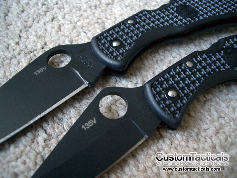

I'm a folder guy and I don't use or like choils at all. I haven't bought several nice folders bc of the choil. I would Much rather have the extra cutting edge instead of a choil.
One of the best examples I can think of is the Spyderco Superleaf. I really liked the knife but the big choil wasted a lot of cutting edge IMO.
