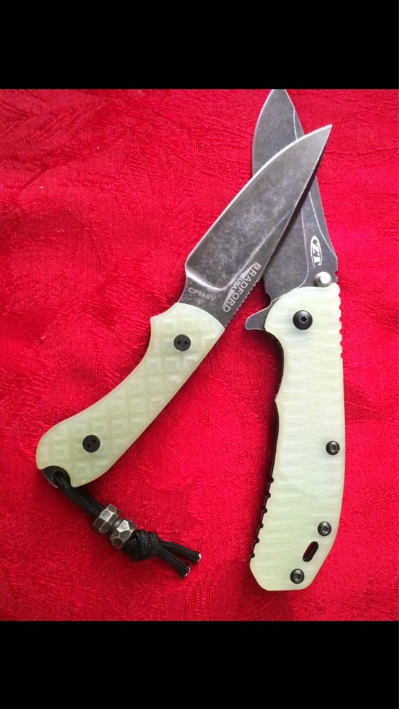

Personally I like DLC and similar, but some of the thicker coated blades I am not into anymore as much. I like to strip coatings on some and wear the coating off the old fashioned way. Usually I have been kind of stone washing the blades so they still don't show wear much. The DLC would not stop me from buying a sweet ZT like a 804CF which is the only one I want right now. Stripping is fun.

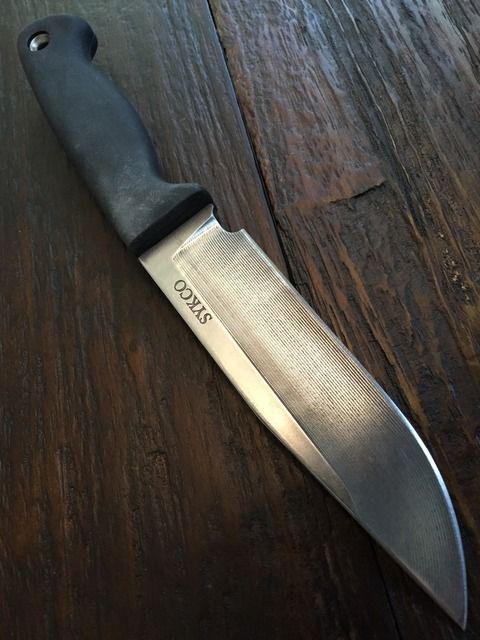

I definitely expect to take care of the blade more if there's no coating on a 1095 or SR-101 blade, but as far as scratching it up, they hide scratches better. We'll see how the sanded finishes hold up to rust. Steels like INFI, it always seemed just a cost savings step for a rough blade under the paint. I was surprised how polished and worked the grind on the Mil Regulators are though. The SYCKO 511 has machined bevels that are pretty sweet looking, and the KABAR Beckers machined bevels look great underneath too. KABAR coatings are TOUGH. Roughest grinds I have seen so far were on a SYKCO Chophouse.
