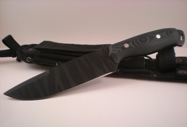

Gun Kote works. I did this one up not too long ago...
Erik-
That looks pretty darn good! How did you get the tiger stripe effect? Gun Kote seems simple enough to apply to the blade. Did you do this before or after HT? What has been your experince thus far in terms of wear resistance? Thanks again!
All is done after HT and the striping was done with blue painter's tape. I painted the whole blade black, let dry / cure then put tore the tape randomly and laid out the pattern. Then just lightly went back over with green, let dry and untaped. I did mist really lightly and from a distance a quick once over all with black again just to diffuse it. Bake in the oven for an hour and it's done. Yes, it will eventually wear off, however it will take some time. If you screw something up and bake it, you actually have sand / grind off the coating.

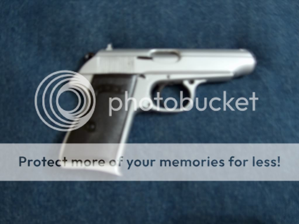

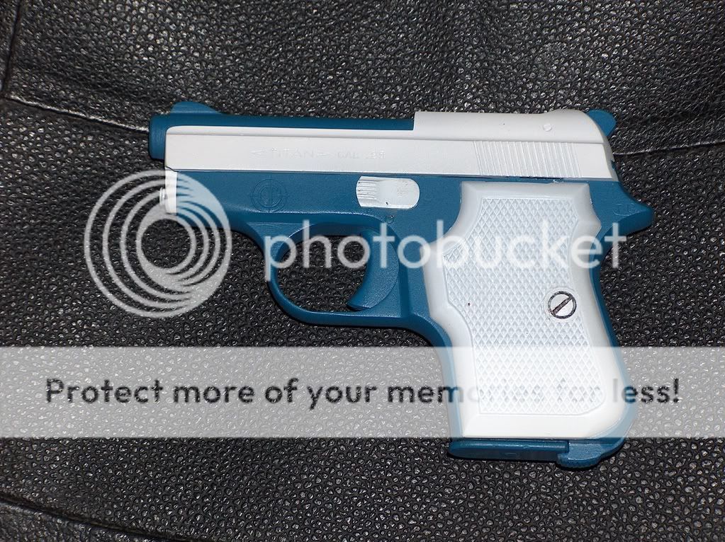

Here are a couple of pics of pistols that I did. the first is Duracoat (the customer is a Kentucky fan, GO CATS!) and the second is Ceracoat
sorry i didnt realize this pic was so blurry

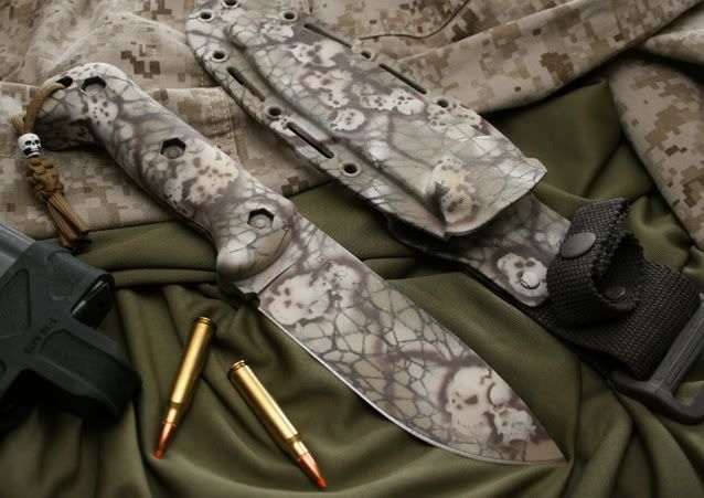

My Desert Skull Pattern

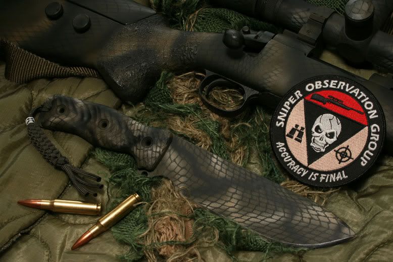

My Sniper Snake Skin Pattern
