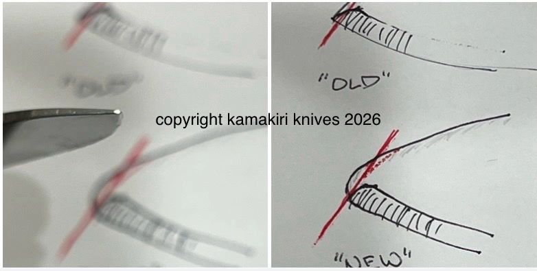

Dang. The paranoia that pops up in these kind of threads… Newer process for 91mm is just too much time in the tumble polish or they’re using a new batch of tumble media. Or too little time for the automated sharpening. Or something along those lines. If it was an “agenda” thing, we’d see it across all products and frame sizes. Go check a new 58mm. Or are the scissors blunt on everything too. Haha. That said, I’ve been making the tips *actually* pointy for a long time…by dropping the spine to be 90° to the edge at the tip, not grinding the tip up to the spine. It wastes less material that way.

Pictures making the point clear (pun intended) would probably require me to use the DSLR and macro stuff I’m too lazy to go get. This is a conceptual sketch of where I file/sharpen to make the tip 3-sided, not with a rounded spine like they have been or blunt tip like is frequently seen now. Back in the ‘60s and earlier, the spines were *swaged* from above the nail nick to the tip and would roughly make a 5 sided tip.
Sketched and pictured a tip showing the flat reflective area. File and sharpen to the red line. Round it a bit if the flat spot bothers you.
