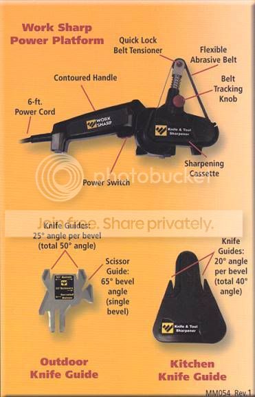

it was a knife sharpener -
oh, I hear people say I know how to sharpen a knife -
Free-hand -
so do I -
I can even put convex edges on my knives - that Ken Onion was impressed with -
BUT I am still impressed with this sharpener.
What is the easiest/best way to get a good convex edge on a blade?
Use a flexible belt sander -
most of us do not own one - nor would we want to afford one -
So would I be interested in one that is portable,
can be handheld on a table,
and costs $70?
Does the Pope sh1t in the woods?
I have absolutely no affiliation with Sharp Work -
and if Ken Onion hadn't dragged me there (kickin' and screamin') -
I would never have found it on my own)

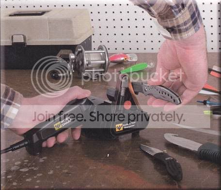

It took this sharpener to put a convexed edge on my knives in less than 2 minutes -
it took me over an hour of diligent work to do the convexed edge freehand - which took a lot of checking/testing.
This was almost insultingly/mockingly simple......
I'll let the pictures tell the story.......

That sharpener is definitely interesting! Do you know if it comes with different grit belts so you can put a mirror polished convex edge?
Thanks for posting this!
Yes, it does come with belts of I think 2 of each in three different grits -
the coarse and medium-fine (I was told) are very common and readily available -
the polishing belt(s) were special to them -
but I guess one can buy any polishing grit belt to fit too.
I just found their web page
there's a demo video (which I haven't watched yet)
and one can download a pdf manual too.
EDIT to ADD:
According to the pdf manual which I have only just downloaded and read - there are three grits: Coarse: P80, Medium: P220 and Fine: 6000.

I saw this sharpener at a gunshow in SLC, the only thing I didn't like about it was that the only guide angle is 50 degrees which is 10 more than I put on large knives even much less M4 or S90V flat grinds, and that there were only 3 grits available and they were special sized belts only available through the that company, which is why I'm sticking with my $30 harbor freight 1x30 belt grinder with grits 60 through 12,000. I think if they fixed these two things this would be an awesome product.

That seems like the easiest, fastest way to sharpen a knife. Pretty impressive at first glance but like Zippo said I would like to see a 30 degree setting on it.
got one, great tool. and you can buy grits in multiple other sizes, can't remember the companies off hand, but a search here on BF will find them. if i can find my online receipt i'll edit this post with the company i used.
i've got 80 grit through 12,000 (1/2" x 12" belts). works fantastic. it's not going to replace an expert who spends an hour by hand on waterstones or mousepad/sandpaper then strops, but it puts a mean convex on, and some quick stropping at the end takes it the final step to slicing and dicing.
i didn't like the included angle guide either. used it for about 5 minutes, then quit and just free handed it. works lots better freehanding it.

It needs a 7 degree setting (14 total) for thinning the edge without ruining the finish. Even I might buy that.

that is a nice machine... can you remove the vertical guide behind the belt? i really am looking for something small since i don't have much of a "shop"
Do any of you guys know the length of the belts used? I'm wondering if I can get them locally.
