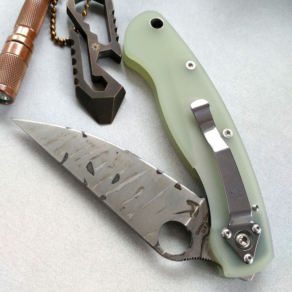

Love that tiger stripe effect goin' on! Is that the same knife as the one with French's?
Also, what is that bottle opener/wrench thingy, and where can I get one!
Thank you!Yes same knife.
J. Woytaz knives. Pry tool

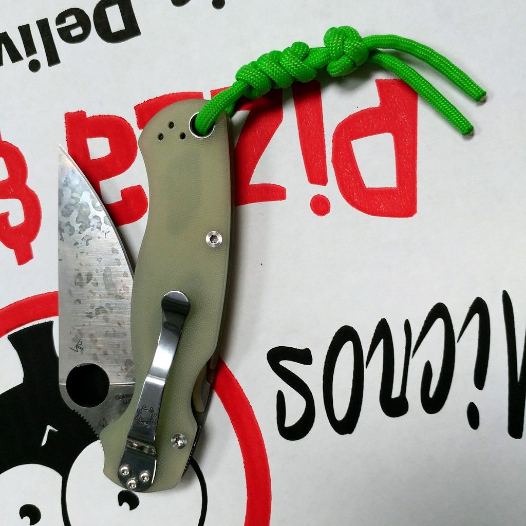

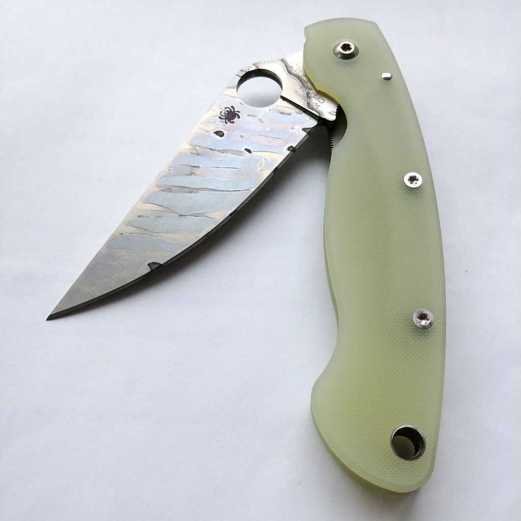

I always make the mistake of covering it to much. So the first application only resulted in dark specks. The second app I used a two inch piece of paper and dabbed mustard in stripes. You have to leave blade surface exposed to allow oxygen access. Thinner and spread thin allows the mustard to dry though. Tougher to clean off without rubbing patina off too.Thank you!
That patina really speaks to me.
Did you do anything special to get the parallel lines or was it just happenstance?
