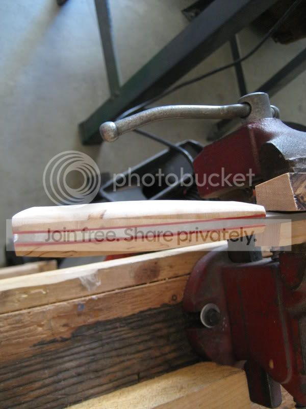

Blade was VERY sharp and has a nice bead blasted finish. Scales fit the blade very well with just a hint of overlap. Since the scales had the vulcanized liners I used a rubber cement type glue to keep out moisture and will enable me to remove them if I want to. It really was a simple assembly.
Screwed down the bolts
Ground the bolts down ( go slow so they don't get to hot and burn the wood)

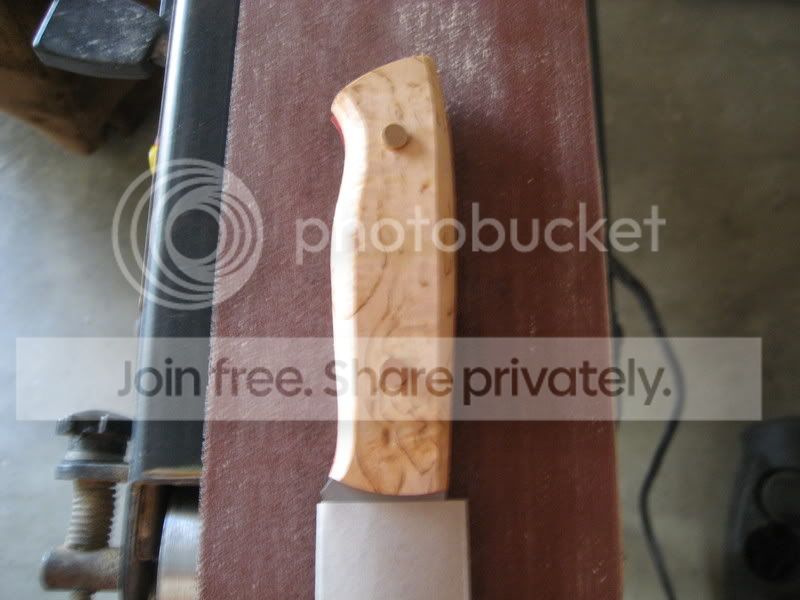

Ground the spine down to give it a sharp 90 degree for fire striking
Grind the excess wood level

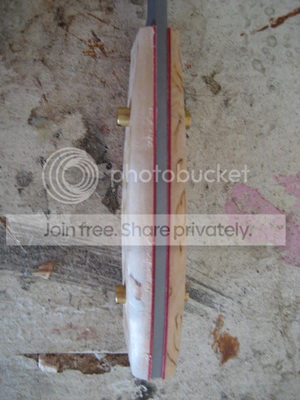

Scales assembled and glued:
Again..... go slow so you don't head the brass bolts up to much. It will burn the wood:
Hand sanding with 220:

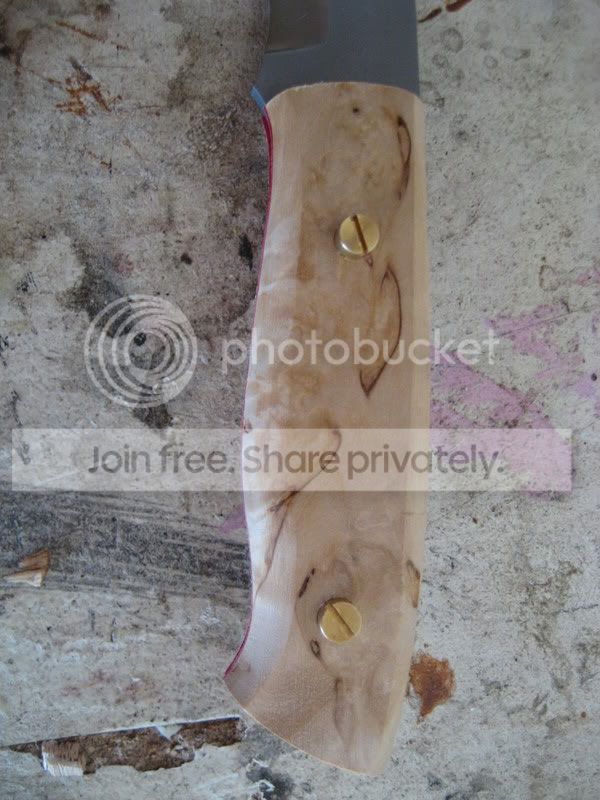

Finished knife:

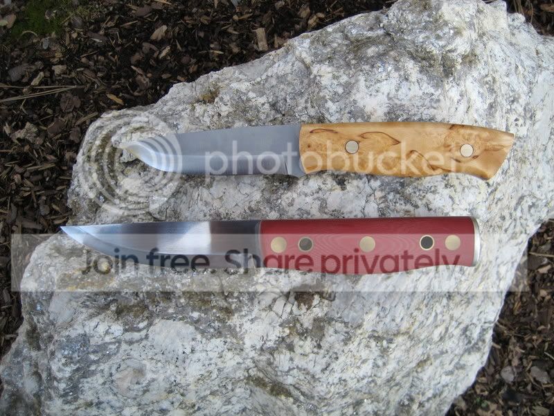

I noticed this knife being displayed in your carver knife post as well. So I'm thinking you done a little cutting with it (the spoon?). Considering your other scandi grinds, this one is thicker at .135". How do you find that in terms of its cutting performance and weight in the hand?
Tarmix that was really quick - both from receiving the knife and the time it took you to finish it. Those scales have a lot of character to them! I think you did a great job finishing it up and your description removed some of the trepidations I had with the kit. Great post and great photos.
It's a good carver. The high scandi grind gives it a nice thin edge that eats wood well. It's pretty light compared to my Skookum, and should be a breeze to carry. Feels very comfortable in the hand. Easy to control, and I didn't find any hot spots.
Tramix, in the future, if you gonna do this again,
wipe down the corby bolts with isopropyl alchohol, before assembly,
and i always LIGHTLY sand w/ 220 while the first couple coats of sealer are still wet. this lets the fresh sanding dust fill small voids and is trapped there by the wet sealer.
that should eliminate the dark rings around the corby bolts.
other than that you have a beautiful knife that you should be proud to own. especially since it has some of your own effort and sweat built in...

Thank you for the tips. :thumbup: I will be doing another one using micarta. Should I use the same technique on micarta as well?
Wiping with alcohol prior to the assembly part, sure. Couldn't hurt.
But since you won't be oiling your micarta handle, the rest of it shouldn't matter.
