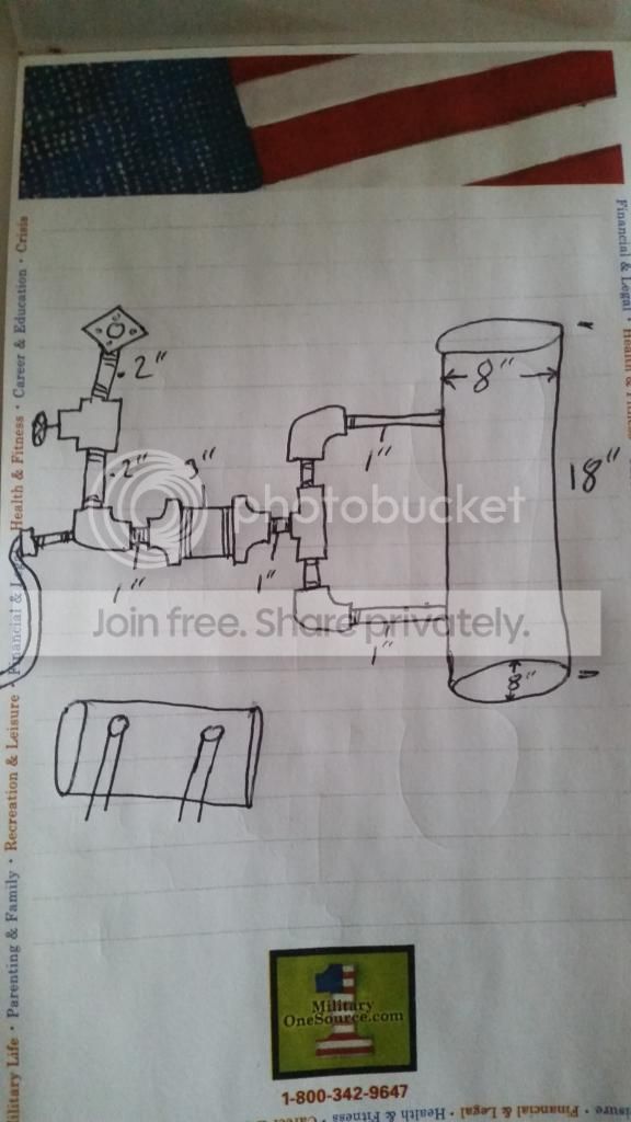

I have been working on stock removal knives for a few months. I am still learning a ton about geometry and balance but I am having fun. I would like to do my own heat treating. It is my understanding a blown forge is a lot more controllable so it is better for heat treating and welding than a Venturi forge. I have read a lot of the stickies. I am really a hands on learner so I decided to just start piecing one together with the information I have gained from the stickies. I have two extra cylinders laying around one is a propane cylinder measuring 12" diameter by 16" long. The other is a broken air compressor measuring 8" x 18". I am asking advice on which one I should use? I would like to do small hatchets so I am leaning towards the larger diameter cylinder. I would also like to do some Damascus and San Mai. I also have a blower that is rather large but that would be what a valve is for right? I am also wanting to put a dimmer switch on the blower. I want to make it digitally controlled with a PID. I will probably just drill a hole and leave a sheath so I can add one at a later time. I drew up a small diagram of what I think the burner should look like. I was planning on splitting the burner, do you think this will be the best way of plumbing the burner? I am planning on using an 1/8" hole in the gas line is that to big? Obviously I will have a needle valve at the gas inlet. Should I put a ball valve at each pipe before it goes into the forge body.

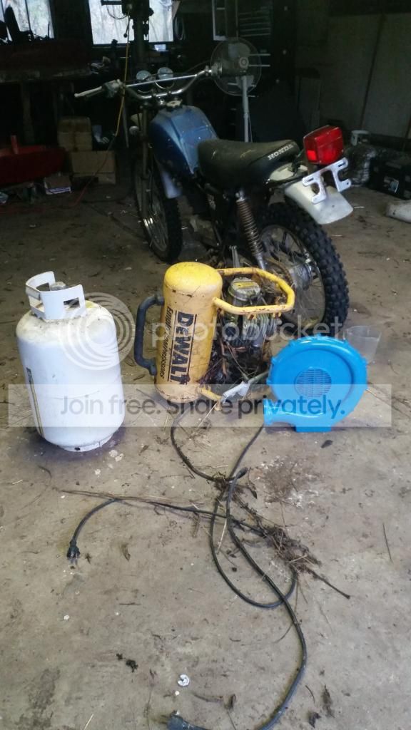

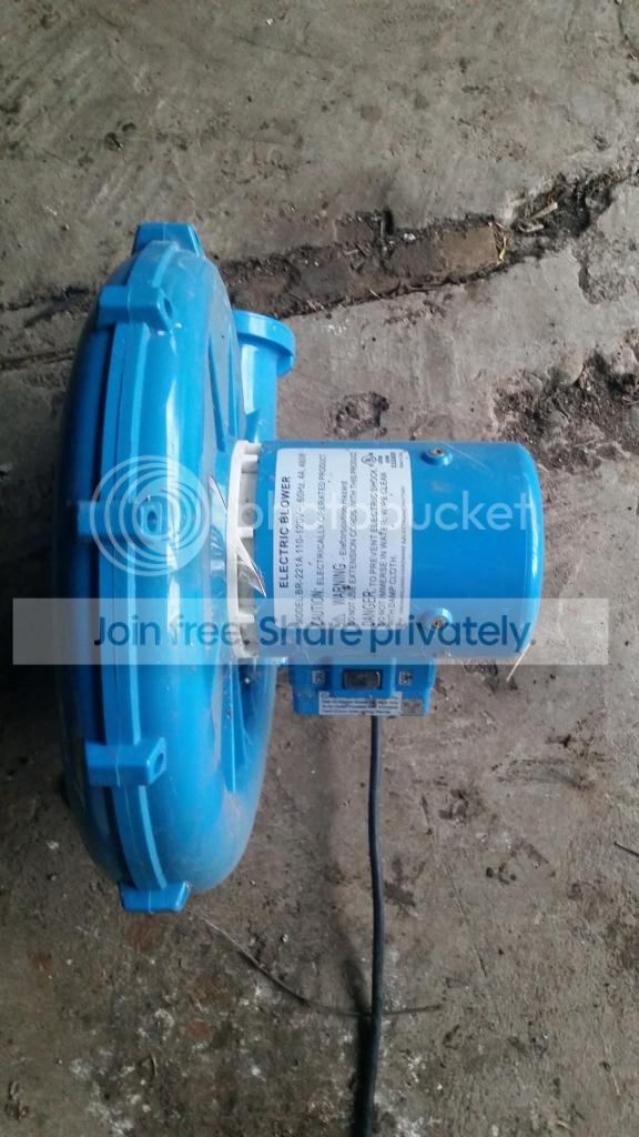

Well I went and bought a bunch of fittings. They were expensive! It was like 200 bucks just for the plumbing... I loosely put them together and I think I need to buy longer pipes after the T so that my burner pipes going into the forge are spaced out just a tad more. I have drilled into the 90 degree elbow and stuck my 1/4 pipe through it I will weld it in place tomorrow. Now I am still trying to figure out if I need to drill an 1/8 hole into the cap or smaller. I am also unsure of how long I should shove the pipe into the 90. Maybe I am just over thinking things and it the long run it wont effect the operation of the forge. Now I just need figure out how to hook the propane tank to the inlet pipe. can I just use a normal propane hook up for a BBQ as long as I get a decent regulator?

Hi Travis, Since nobody has commented on your design I will. I have built a few forges over the years. Do not take this the wrong way but your burner design will not work as you hoped it would. There is no reason for you to have two burner tubes going in to the forge of that size or for most forges for that matter. Second the tubes are to small to work properly in my opinion. If you would like some help Im up in Beaverton and would be willing to share some design thoughts.Fyi its much easier then your making and can be done much cheaper.

I mainly agree with Bret. This is a really good example of why posting the plans first can save time and money, as well as heartache.
Some critical things I spotted right at a glance:
The 1" pieces of pipe in and out of the mixing chamber need to be 1.5" or 2" pipe. This is a critical flaw and needs to be corrected.
The burners can stay as they are or change to a 1.25" or 1.5" single burner.
I would suggest "swinging" things around so the blower is under the table/cart the forge is on and the whole assembly is a "U".
A really good way to build a forge is to build it on a rolling welding cart from Harbor Freight. The various components can be bolted on to make it stable and the whole thing can roll out of the way when not in use. The propane tank can even sit on the back with a bungee or clip added.
Thank you both so much! I can easily return what I don't need. I will change it so that I have 1 pipe going into the forge and make the pipes 1.5". I definitely want to build it on a cart and can easily set it up in a "U" fashion. I had read a lot of stickies and thought I was doing it right so I appreciate the correction! I want to eventually make it controlled with an SSR, Thermal coupler and everything else involved with that. I have read a lot of what you have posted on that Stacy and I believe I understand how it works, but that will be at a later time when I have a little more excess income. Oh and for the burner orientation, should I place it a little towards the front of the forge at about the 3 o clock position and angled towards the back a little bit? I think I read that was a good way to orient the burner.
