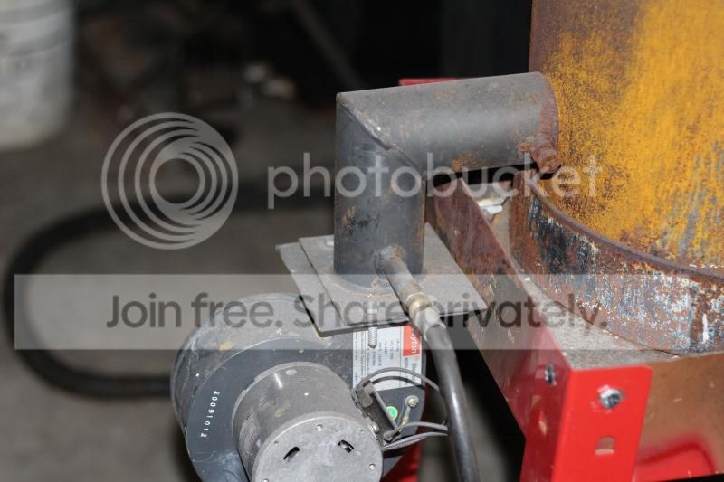

I am no help on a pid/temp controlled forge, as I use a kiln for heat treating. But for a blown burner, I took a pic of mine and it could not be simpler and it works fantastic.
simple as that and at welding heat in minutes. This is not my design.
That looks like a vertical, no? If you want good consistent welding heat and easy clean out that's the way to go. Simple simple.
