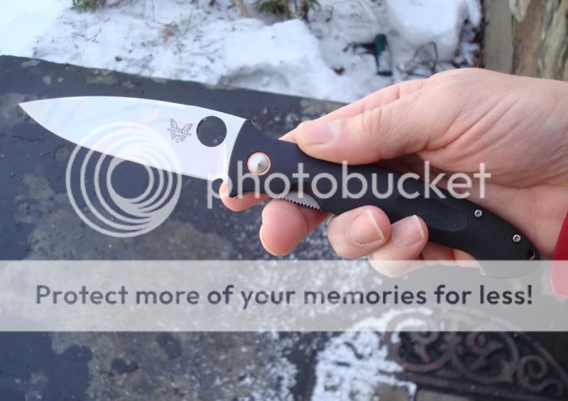

I just got one of the large Dejavoo's on closeout and I don't know why I waited so long to get one.
The small model is nice , but as you can see in my pic, the large Dejavoo is not all that big.
As far as hard use , I'm not so sure I'd say this knife is week. The Ti liner is about as thick as my BM Stryker and locks up very solid, but the frame does have some holes to lighten it. It opens very easily because of the weight and length of the blade.
I can't say enough good things about the knife.
