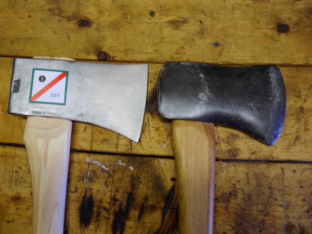

First though, some pics of the head, head analysis, and the comparison to the Flint Edge(head $3 flea market find, handle $14 Home Depot, sharpened by me and linseed coating on handle) it will be going up against :

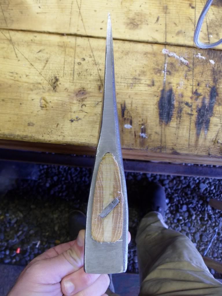

The axe head on the Black Donald, as I stated is a beast. Big, squarish, and heavy. It has the Flint Edge by a 1/2 pound, but it feels more like 3/4 pound advantage. Some pics :
As hopefully you can see (sorry for crappy pics) the head is larger on the BMC. However, the bits tell the story. So the Flint Edge is the one I usually use. I find it a good length and weight for all around versatility. Is it perfect? Nope. Functional? Yes, very much so. And I can swing it for long periods of time without rest, which is important to some, not important to others. The bit on the Flint Edge is sharpened by hand by me, and is to me, almost perfect as far as thickness from bit back to cheek. Nice smooth angle on it allows for easy chopping, without having to swing like a mad man. The BMC is slightly different in perspective. The bit on it is more wedge shaped, or house roof shaped as my old man would call it (get that roof off that bit) . The axe is disclosed as being very sharp on the paperwork that came with it. (It is sharp, just not Operator sharp;)), and I know for a fact I dont keep my Flint Edge as sharp as some of you guys. So that being said, I had some suspicions going in.

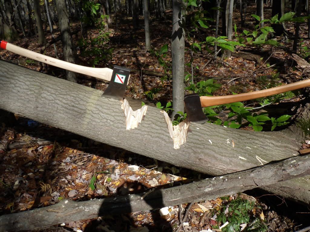

Below are a couple pics, first one after 60 easy swings for each -
Second pic is after 100 swings, with a little more effort -
Again I couldn't get to carried away, stupid weather wont allow it. But I think you can see by the pics, the Flint Edge did better at chopping into this quaker.
Side notes - I thought the BMC did ok - it just needed properly sharpened to hang with the Flint Edge. The balance on it was great, no problems there. And the handle, I liked the painted handle - grip wise it was better than the Flint Edge. The paint has a tacky epoxy coating on it which allows for good grip. How long that will last is of course something I will have to follow up on. The 4 lb head did get heavy pretty quickly, which is attributed to me being used to my own axe and weight I am sure. OnceI had about 15 minutes in and warmed up, it was fine.
Overall -
So the Black Donald is what it is. I am not going to get into the price or paint or wooden case or what not. Thats for you guys to decide. All I know is this -
It handled well. The paint on the handle was not an issue, for now. It was balanced great, and swang like a mother. It just needed to be sharp in order for the wow factor to be there. The head pattern being more wedge like will mean it needs to be ultra sharp, seeing you dont have the thin bits/cheeks like on some other axes, which makes for easier penetration. I therefore only put in 200 swings and called it. This I think seems common in the reviews I have seen Steve and Ross do. I will therefore put an edge on it myself to my liking, and re-try it out. I know it will perform better then. Sheath was good, didn't blow me away, but of course I get to see and own some of the stuff PipeMan and Church do, which automatically makes me spoiled when it comes to leather.
