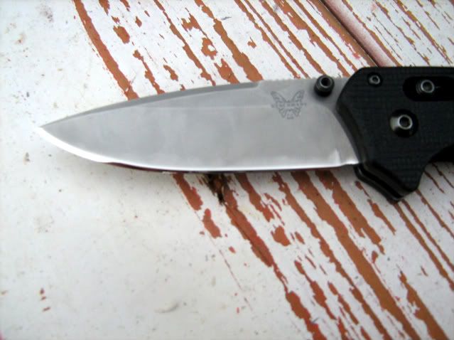

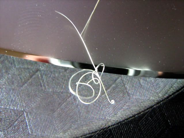

I don't think so. I have very good results finishing up with ultra fine ceramics on my S30V and S90V knives. Takes a very keen hair splitting edge and holds it.
If the VC are so much harder how do you explain this.
Finished with UF ceramic
I explain that as being a highly polished edge.
But, as stated previously, I already acknowledged that one can get S30V sharp.
Here is a hypothisis: When the grit gets finer, the metal surrounding the Vanadium carbides is not sufficiently removed to allow the noted carbides to be ripped out, e.g. it is like trying to pry a stone out of concrete without getting sufficiently under the stone to move the stone out. As a result, the sharpener is riding on the Vanadium carbides.
Such a theory accounts for the relatively toothy edge behavior one sees when comparing, say S30V to M2, sharpened to the same grit.
I'd like to see some magnified pictures in the 400x plus range.
The edge has sence been polished with 1 and 0.5 micron compound so I don't know how much good a pic at 400x would be.
