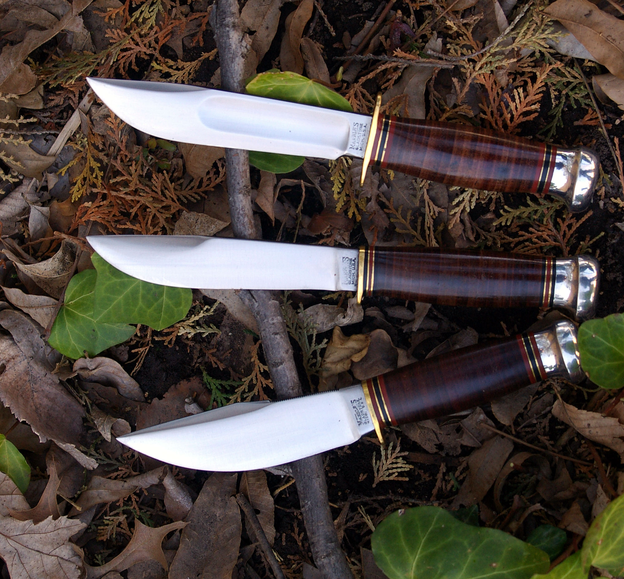

Just as the British bushcrafters blindly seek the zero grind Scandi while operating in something of an internet echo chamber, I think the same thing is true when watching "traditional" N. American hunting knife makers respond to the bushcraft/survival knife markets. As noted above, it was common above for early 1900s NA hunting knives to be flat or saber ground. Consider these Marbles.
http://masterwoodsman.com/2013/classic-camping-knives/
I *think* the hollow grind started to become more widely used as the manufacturing automation of WWII made it more cost effective and then more common. The hollow grind has real benefits for cleaning game, so the shift to hollow grinds in American hunting knives made good sense.
But this fact doesn't make the hollow grind the best wood working knife grind.
My experience with custom made objects in other domains is that custom makers tend to stay close to their roots. The same can be true for manufacturers. For example, with Ron Hood's passing, Buck started putting hollow grinds on their "survival" knives and only recently reversed this on one of the Ron Hood co-branded knives.
Nice pictures.

Excellent post, Pinnah.
And a beautiful Marbles trio as well! :thumbup:
Not my knives and not my picture. Wish the knives were mine. Cross linked from the article in the link in my post above.
