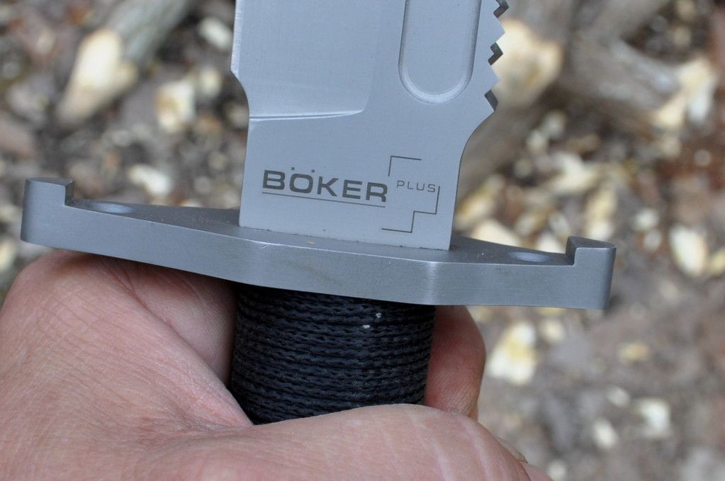

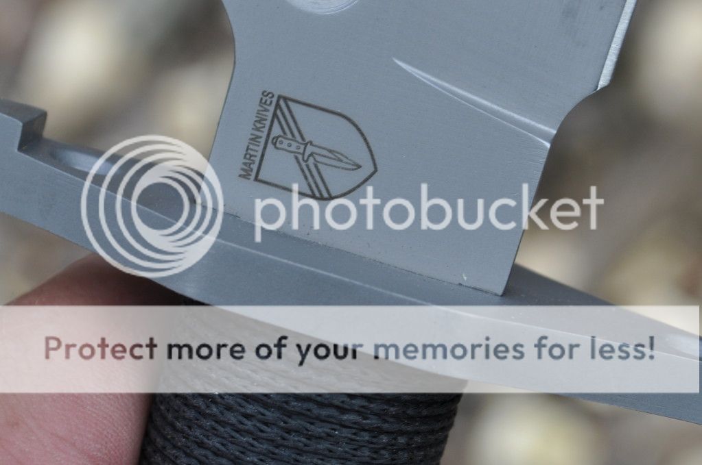

The knife is sturdy-built, has a heavy guard, and isn't exactly small.
It has 3 inches of saw on the spine
The hollow handle has a storage space of 2-1/2 inches deep and 7/8 inches in diameter. So far I have a small tube with a few NATO matches, a short section of straw filled with PJCBs, and a striker strip. Some water purification tabs, and a button compass. There is room in this tube for a small ferro rod, and there is room in the handle for a larger diameter tube so still working it out.

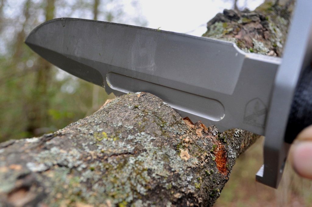

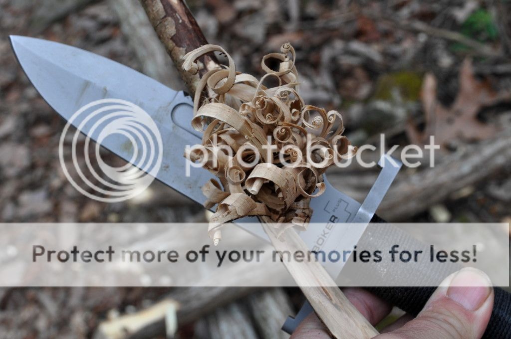

I've had mixed results from hollow handled knives over the years, some great...and some terrible, so I started out taking it sort of easy on the knife. The first thing I did was to play around with a piece of bamboo: limbing, cutting, whittling, scraping, and sawing. The knife came with a nice edge, and had no problems with the bamboo. The saw works really well versus the bamboo also.

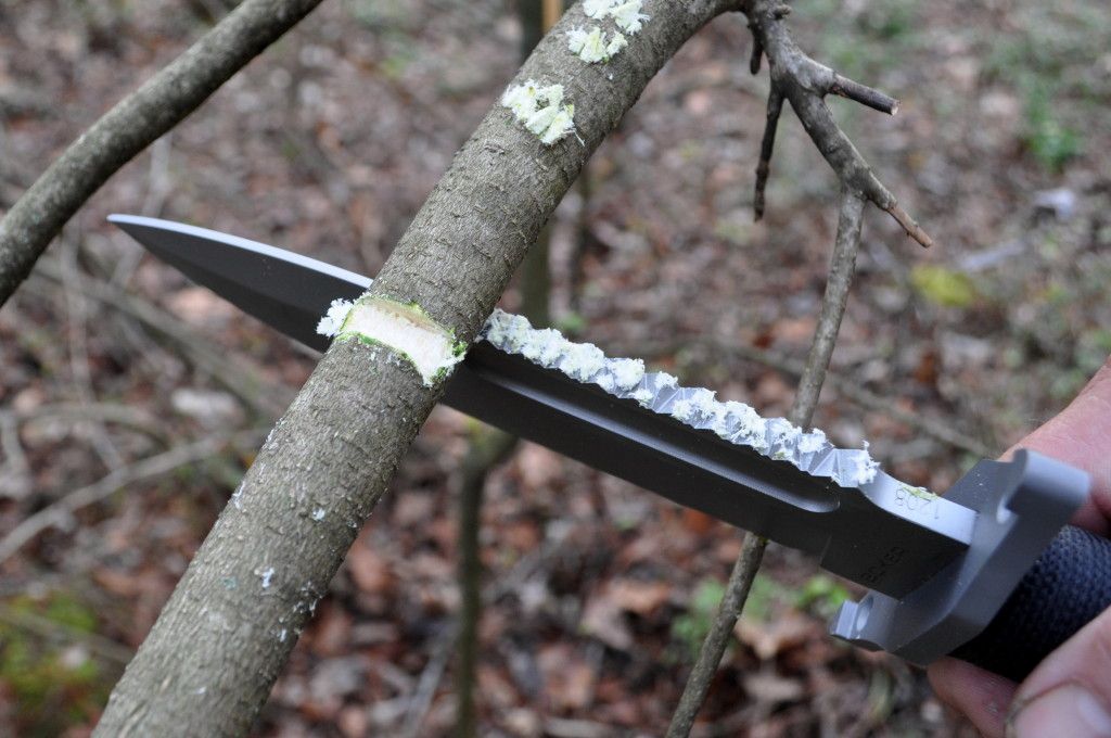

Small green saplings and heavy brier vines weren't much of a challenge
The saw doesn't buzz through wood like a chainsaw, but works well enough for any necessary notching. In dry materials it is virtually self cleaning, in green material a tap of the spine on a limb cleans it out.

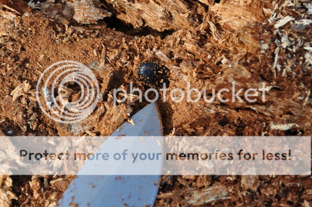

It has also been put under lateral stress in digging through an old log looking to see what was available for fish bait.

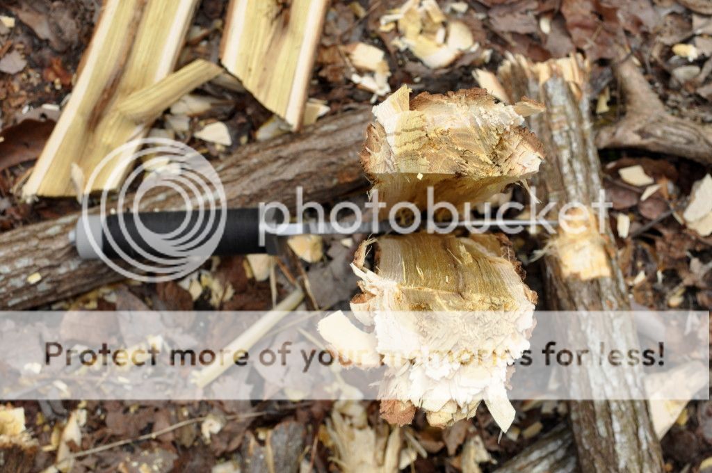

At this point I was feeling confident enough to try some battoning. Some of the pics are a little dark because some of the shots were done using a tripod and timer, and in between free-hand shots made it necessary to change settings...and a couple of times I forgot to reset everything back for the tripod shots. The sky was getting really cloudy and the lighting was dim, I soon had to start using the flash.

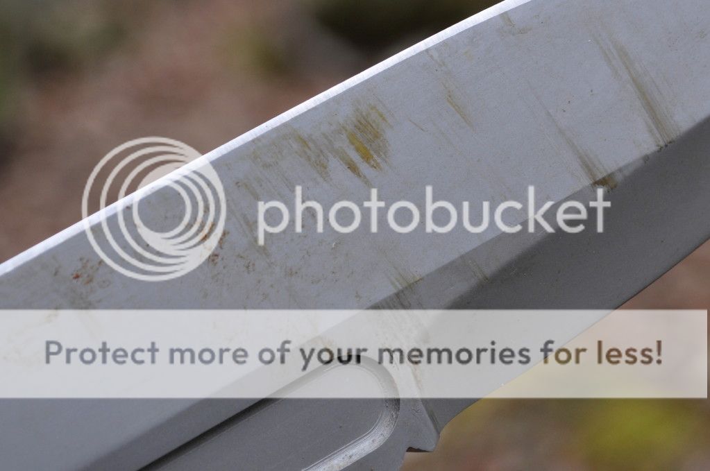

And after all f the chopping, and battoning through a couple of knots, the sun tattles on some slight flat spots on the edge.
