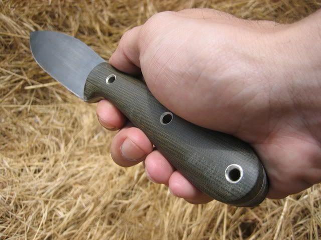

I modified the handle with a simple hand sander to tapper the corners of the scales creating a slanted place for my thumb. This is very important for the many Bushcraft grips, yet I have only seen it on a few.

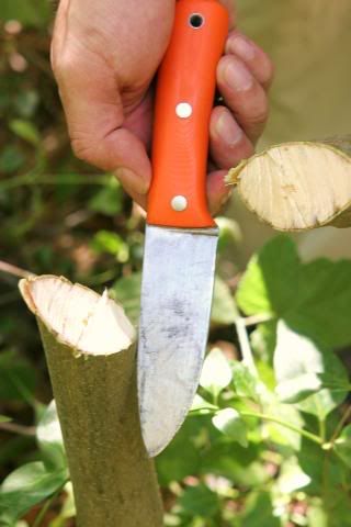

As a way of killing two birds with one stone, and also to keep this review from being too long, I decided to save whittling wood till the end as a way of testing edge retension. The edge was sharp fresh out of the box. First I wanted to see how deep I could baton the knife into some wood, cross grain. After that I took down a small tree by bending and applying tension to the sapling. Next I plunged the blade in at a 45 degree angle and rocked the knife back and forth cutting the fibers. The end result was a nice clean cut that took about 6 seconds. When all the heavy work was done, I went on to make a few fuzz sticks for the fireplace. I was pleased to see how the blade held its keen edge. It felt like I was peeling potatoes, no effort at all.

Fresh cut sapling

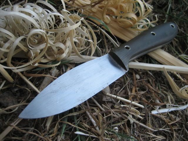

Fuzz Sticks

At first glance the Pathfinder seems like it mated with a Grohman and Nessmuk. The truth is….it did! There is a small hump on the spine right in the middle. This can act as a thumb ramp or be used as a targeting point for cross grain batoning. My newer Pathfinder now has green micarta scales and a thinner profile. Blade length is 4 ¼-inches with a 4 ½-inch handle. This time around I went with 1/8-inch stock. The blade is flat ground with a very sharp V-grind. The tip is also a little pointier which is perfect for incising and drilling holes in wood.
