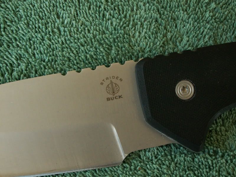

The Alaskan Guide version was indeed made with S30V but as PFI said, it had the coated blade and Buck, USA and the number were stamped on the blade. The one pictured above looks to be lazer etched instead. I've seen too many fake Bucks (Strider Bucks complete with etched Bos stamps amoung others), even fake 110's on Chinese websites not to be suspicious but who knows. I have 119's with ATS-34 blades and 118's with D2. Buck can do just about what they want to with a pattern.

I do know for a fact that the Buck boxes have also been counterfeited, I have a couple of examples. Here's one:
Also, the Model and Bos logo are easy to fake using the laser etch, such as this one:

It seems too easy to contrast the real mini alpha as others here have the "real" one, and none are etched. They are stamped. BUT I do not have a 2010 model. Buck has made the mini alpha in 420HC, ATs-34, 154CM, and sandvik. The S30V models were coated and stamped for Cabelas.
I don't think (if it is a fake), that it has anything to do with swapping handles, blade steel or sheaths. There would have to be a market for copying that knife, which there probably is. It would be made with whatever steel, and laser etched S30V. They didnt swap out the handles and rivets off of another buck blade. If they make fake knife for $5.00 and sell it with S30V stamp for $80.00 thats still profit.
