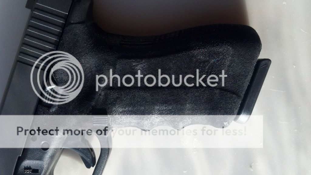

The A-grip material made for pistol grips might be perfect for you. I have it on most of my pistols and I love it. It grips good wet or dry, and slides freely on fabric so it won't pull your shirt up when you move around. I think Brooks Tactical is the company that makes it. You can get uncut pieces and use it for anything you want.
I've had this one on for over 10 years with several thousand rounds fired and it's still in great shape.
