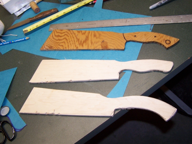

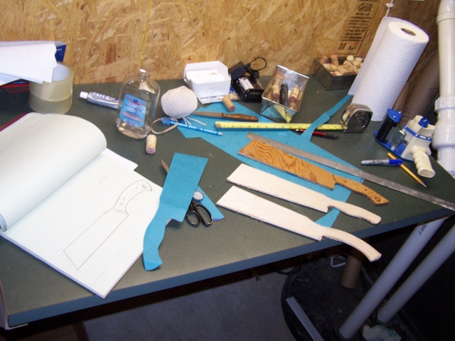

Well, last Friday I got the steel. So I sat down and tried out some designs in wood before hitting the grinder. I keep all scraps of plywood and luan to do just this. It took a few models, but I found a handle I like!
The top model is the one I liked. I did make one more ajustment before going to steel though.

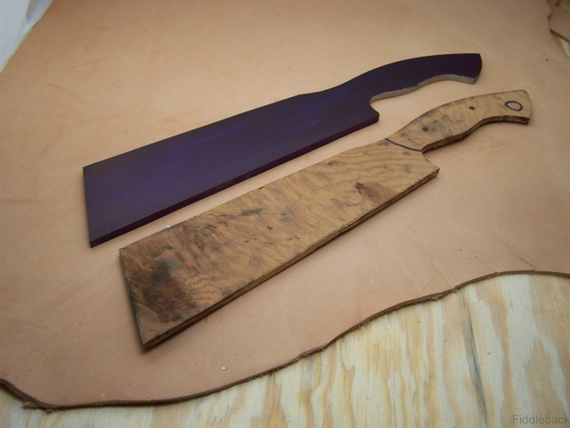

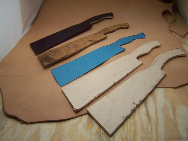

And here are all the patterns with the steel profiled!

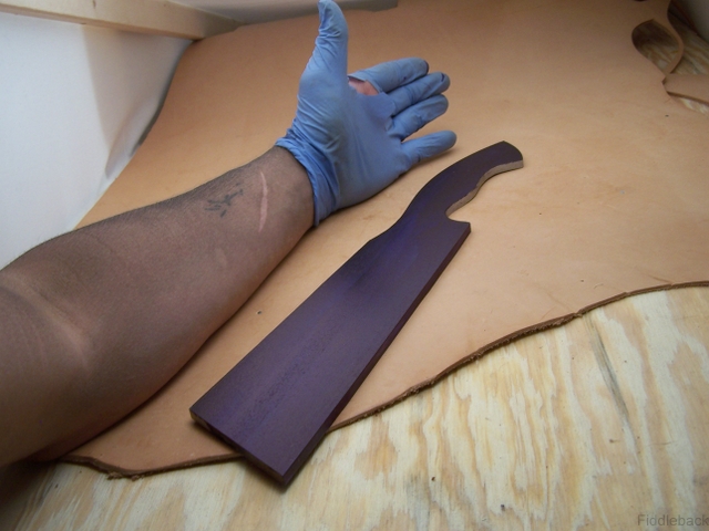

Look how tiny it is:
Yea. Not tiny. (Yes, that is steel dust coating my arm.)

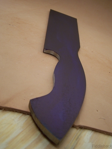

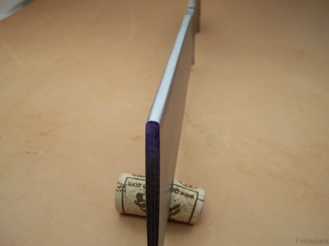

I was just looking at this again and I'm pretty sure that is 1/4" steel, but good Lord it looks like 1/2"!! I can't wait to see the grinds and handle take shape on this one:thumbup::cool:
Nope. Only 1/4" thick. God I hope I never do 1/2" steel.

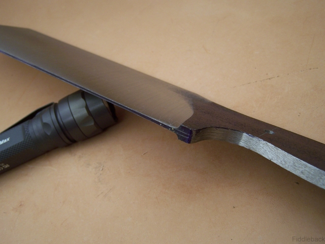

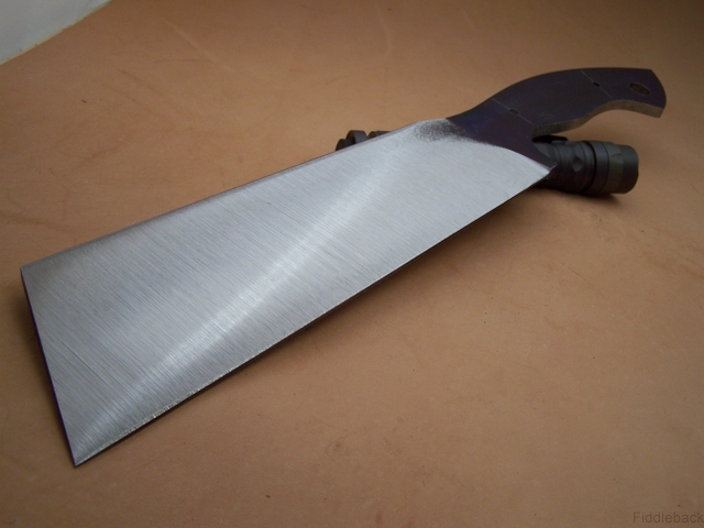

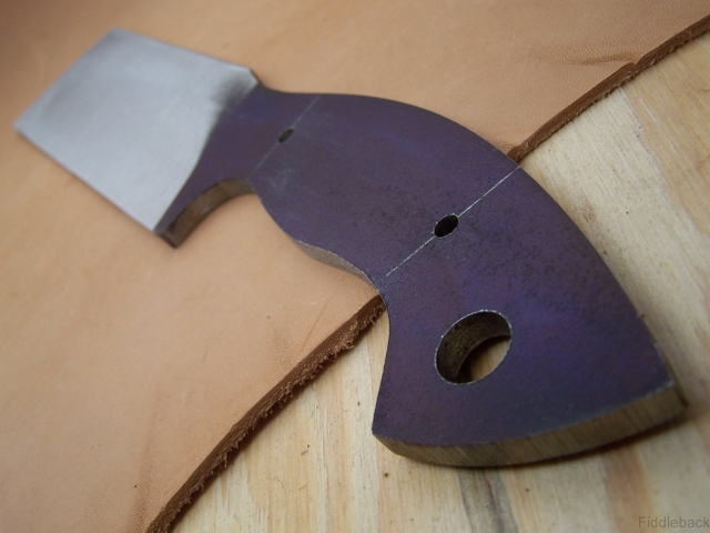

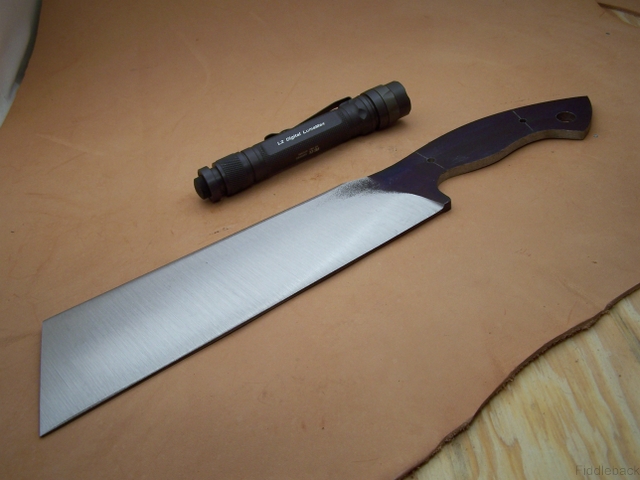

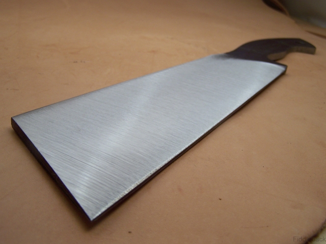

She's ground. Spine rounded at flat part so you can hold it while you drawknife. The flashlight is a Surefire L2 for scale.
