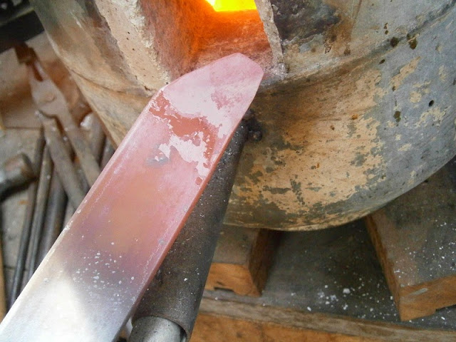

Furnace for normalising and thermal cycling.
Getting up to temp.
Air cooling from normalising temperature.

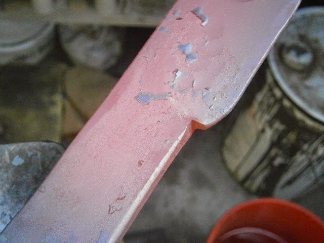

After normalising and thermal cycling, I used the angle grinder to de-scale the blade, and take off some high spots.

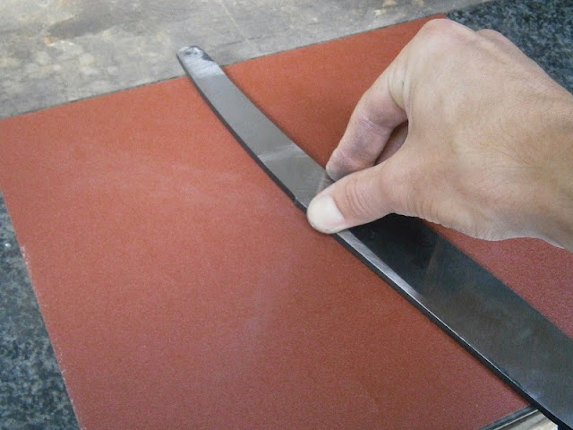

The pre-HT flatness and parallelism of the ricasso is finalised with 180 grit rhynowet glued to a flat plate.

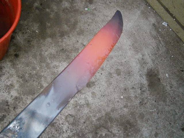

Blade being heated to its austenitising temperature.

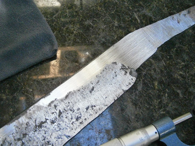

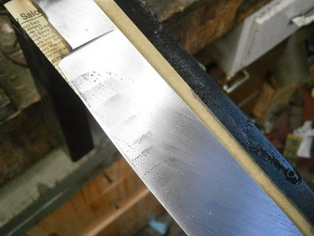

With the tang relieved I start to re-flatten the ricasso with the disc, etching periodically to make sure there is no decarb remaining.
Fine tuning the ricasso with rhynowet glued to a flat plate.

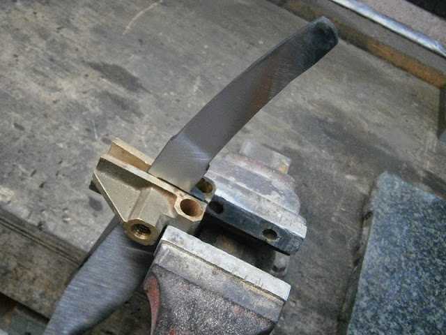

Next I softened the tang to make it easier to drill and file. I clamp those pieces of brass flat against the bevels to act as a heat sink.
I heat the tang with a torch until it turns a grey colour; I do this at least two times.

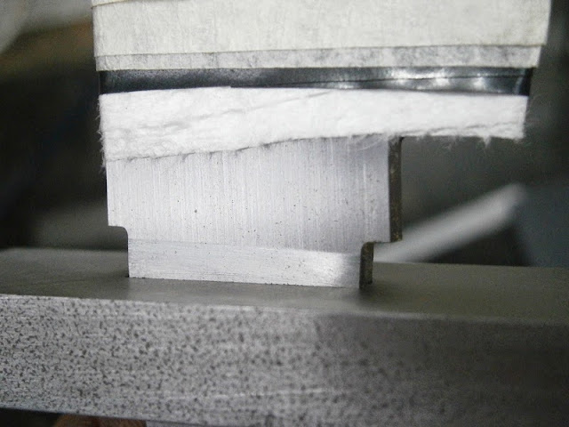

With a carbide guide clamped to the ricasso I used the abrasive paper overhanging the edge of the disc to cut the plunges.
Cleaning up the plunge with abrasive paper glued to a micarta block.
More plunge work. If I were better at grinding all this tedious hand work wouldn't be necessary.

Ricasso cleaned up with 320 grit on the flat plate.

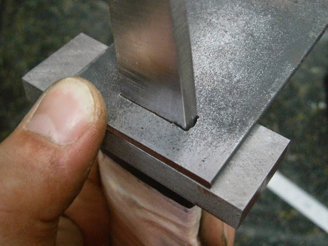

I used a post-it note to help me visualise the best angle for the guard.

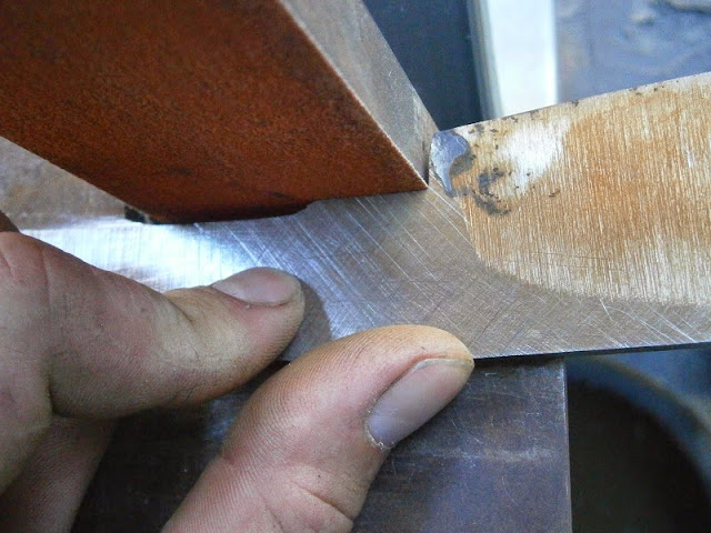

Cutting in the shoulders with a pillar file.
Finishing the shoulders with sandpaper glued to a piece of steel (edge slightly radiused)

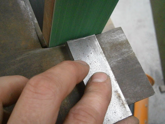

Checking for parallelism while flattening the stock.

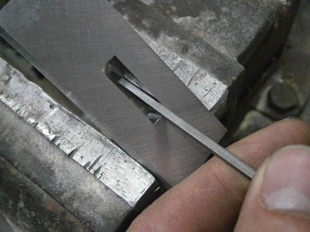

Beginning the slot.
Connecting the holes with a chainsaw file.
Using a narrow mill file to open up the slot.

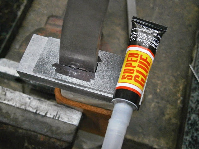

Slotting some mild steel to be used as a sacrificial plate to protect the back face of the guard.

The alignment pin locations are punched in the sacrificial plate, and the plate is glued to the back of the guard.
Depth set.
Drilled.
