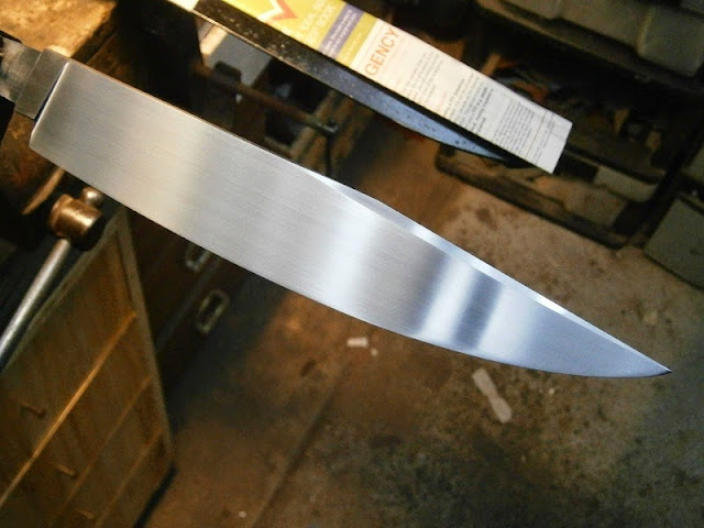

Finishing the blade. I finish the spine, choil, and clip before the bevels.
Cleaning up the bevels.
For the final finish I back the sandpaper with some fairly hard rubber.

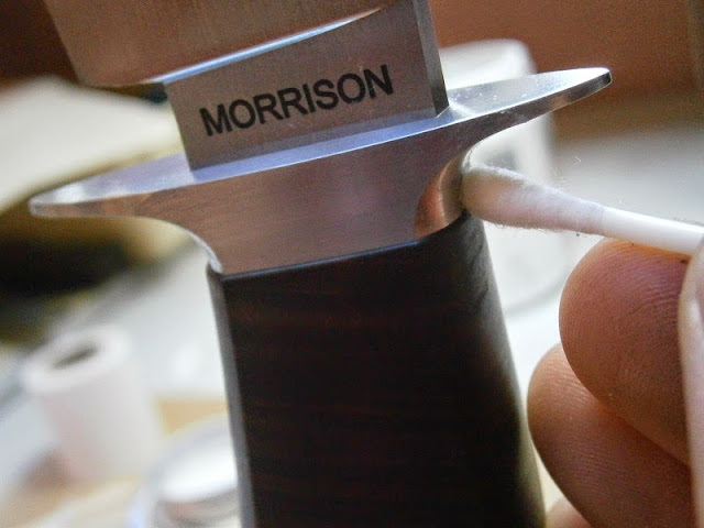

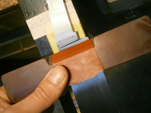

After thoroughly cleaning the tang I pressed the guard on one last time, this time with JB weld in the joint. I could glue the guard on at the same time as the handle, but I like to worry about one joint at a time if I can.
I did 90% of the clean up with the tape still protecting the ricasso, but the final clean up had to be done tape-free.
With the JB weld set I squirted some epoxy in the handle and clamped the knife up in my glue-up fixture. I cleaned up the excess epoxy with Renaissance Wax.

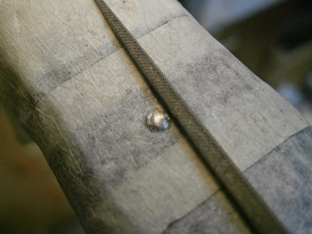

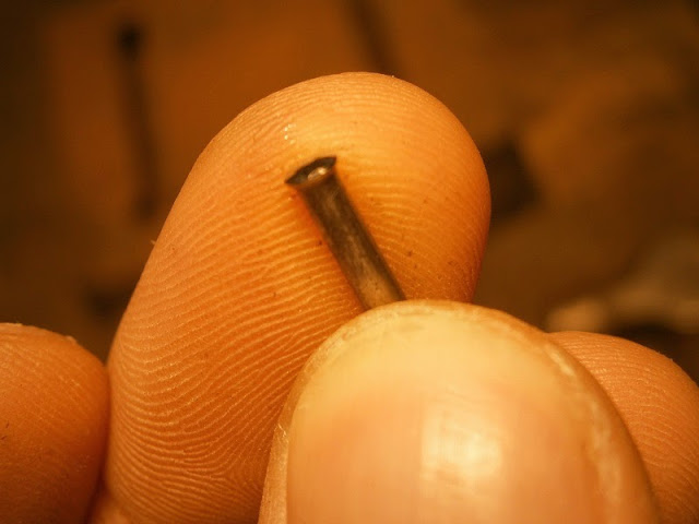

Once the epoxy had cured I installed the pin. This was a nerve wracking process, so I only managed to get a few pics.
I got one side peened before inserting it into the handle with a drop of epoxy.
When both ends of the pin were expanded sufficiently, I shaped them with files, then sandpaper, then finally buffed them.
