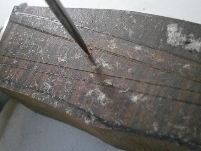

Handle cavity drilled and scraped, filing with my favourite file for a close fit. This block was actually my second attempt; I made the cavity too large on the first, way too large. Still not sure how I managed it.

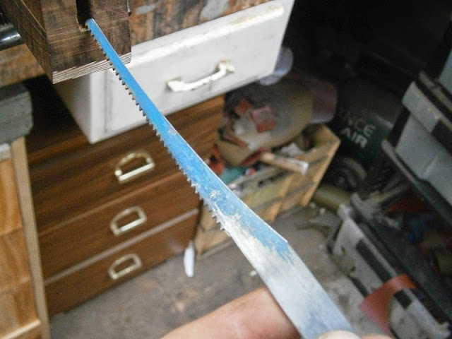

Here's a handy broach I made from a power hacksaw blade.
Not very ergonomic yet, but it indexes well.

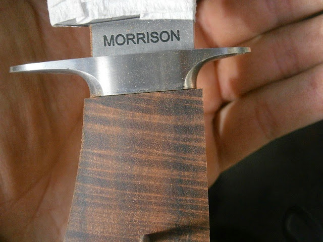

Getting the guard shape set before starting the handle shaping.
Deciding on the handle dimensions.

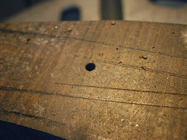

Pin hole location marked.
Clamped by the ricasso in the drilling fixture. I use my height scribe to make sure the blade is clamped correctly (so that the hole will be perpendicular).
Drilled.

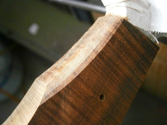

Establishing the 'flats' of the handle with a rubber backed 320 grit disc.
Still plenty to remove.
I use the flats as a sort of reference for the rest if the handle shaping, so I take them to a 600 grit disc finish straight away.

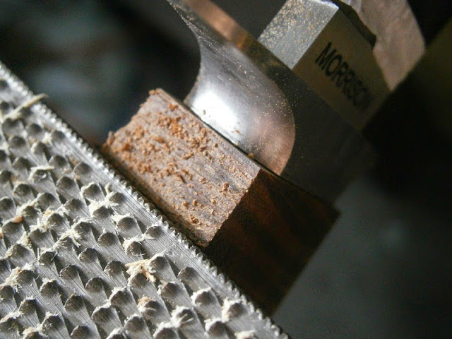

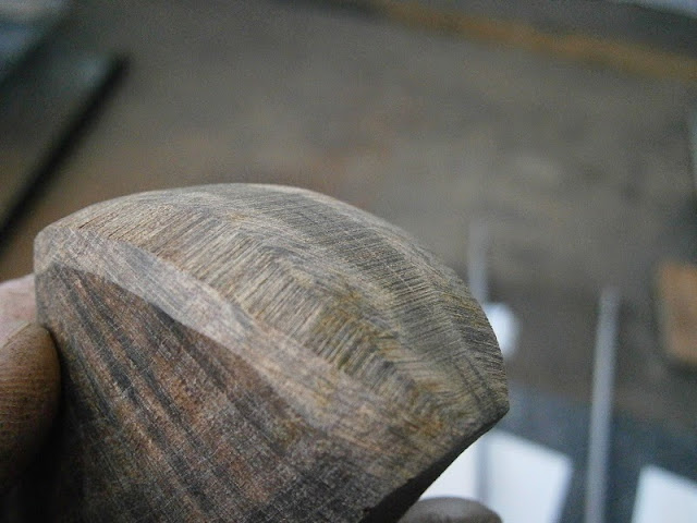

A rasp removes a lot of material in a hurry.
Still too wide, but I can dial it in with something less aggressive.

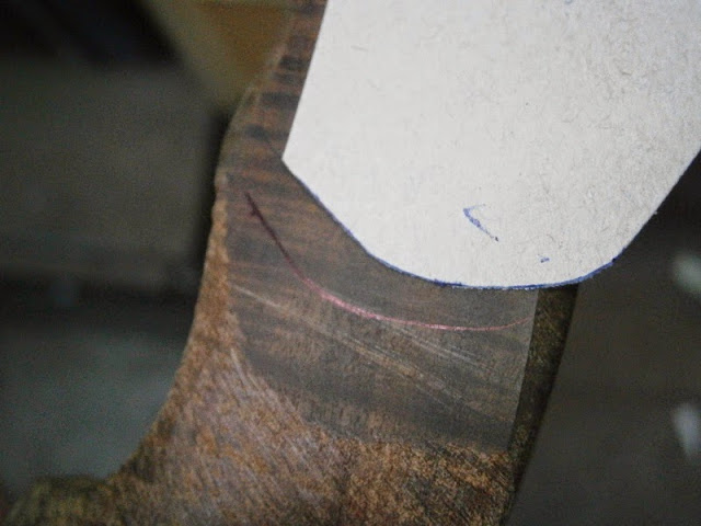

I like to use templates to help me keep everything symmetrical from side to side.

Next template.

New template.
Filing off the corners, and blending the curves.

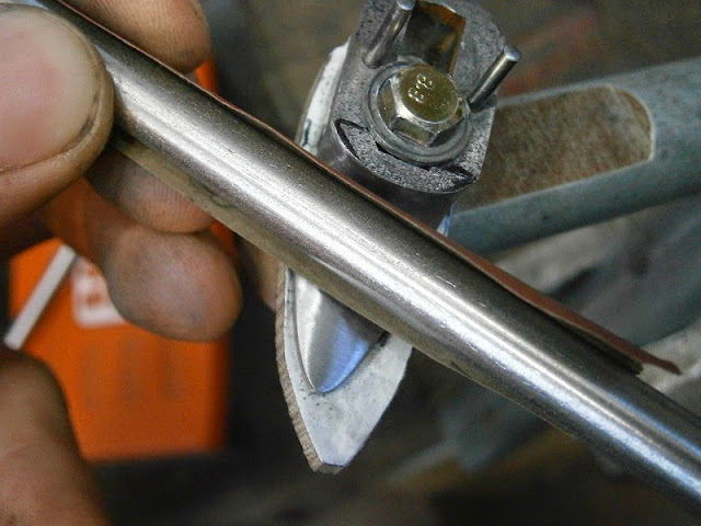

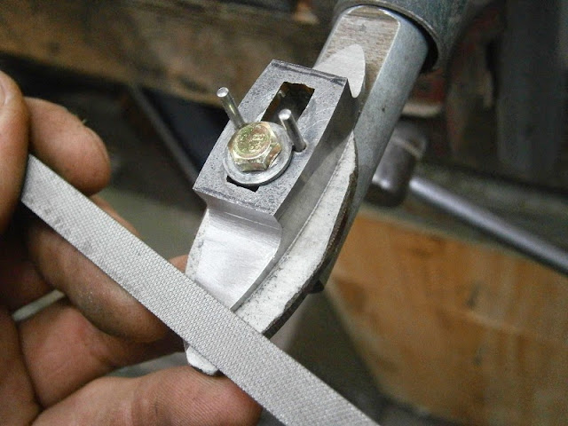

Very nice work. I too find that crazy eyes helps when filing a guard slot.

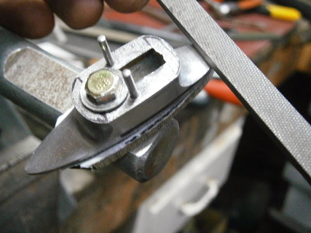

What are you using to hold the guard down as you file it? I see the bolt and washer, is that threaded through a rod or something?
I enjoy your work immensely. I picked up a few tricks for the handle symmetry. Thanx! :thumbup:
Thanks mate. Having crazy eyes is the key to accurate guard slots.
Here's a better picture of the guard shaping fixture:
There's a threaded hole in the round bar.

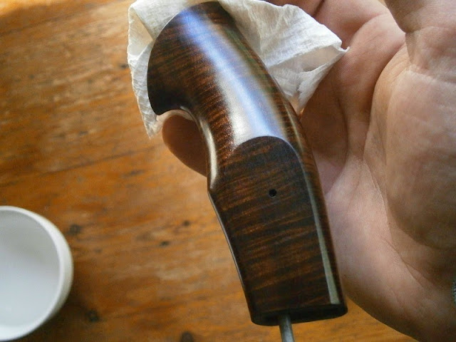

Scandinavian oil applied with steel wool.
Wiped clean once the oil started to go gummy.
While the first coat of oil was drying I finished the guard. I started with the underside of the... branches? lugs? I don't know what the right terminology is, but I sanded them up to 1200 grit and then buffed.
Top face masked while I buff off the sharp edge. Thanks to Peter Del Raso and Shawn McIntyre for this trick.
Cleaning up the satin finish on the sides of the guard.
Finishing the top face.
All done.
