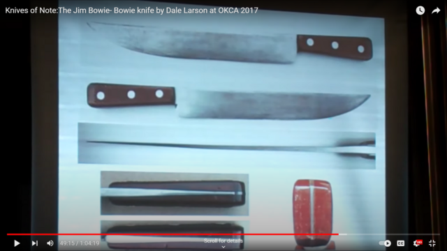

Reports from onlookers of the Sandbar duel stated that the knife looked "like a Butcher's knife". BRK's Edwin Forest Bowie is the closest remake of that knife (in build and dimensions).
Not really, the actual Forrest is around 5/16" thickness at it's widest point, and the Taper is way off on the BRKT -
BRK08-315NMB_04_bark-river-knives
Top picture isn't the best, but you can see they'd be way different in the hand.
The widths are close though, the Forrest is 1 3/4" wide.
