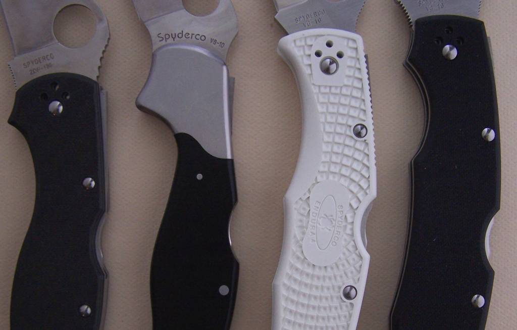

Sal, I can understand the theoretical benefit of the Boye dent as an "fix" for an existing knife with too deep a lock well. Where I have a bit more trouble is with the logic of designing brand new knives that require it. It would seem better to design the relationship between the parts so the "fix" would not be needed. Even more puzzling to me is the fact that on some knives with Boye dents, lock release occurs long before the dent "bottoms out" in the lock well, while others require it to be depressed below the scales/liners, as illustrated by the photo below.
In the case of the C83 Persian, the glint of metal you see is not the lock bar, it's the off-side liner. Now, that particular Persian is an extreme case, but none of my six unlock with anywhere near as much lockbar showing as the Police III, Endura, or even the Stretch II in that photo. The Persian, unfortunately for me, gets a "double whammy", the lock spring is also one of the stiffest on any Spyderco.

My guess is that the dents are added to the the lockbar by hand. My "evidence" for that is strictly circumstantial, but there are models (like the C83) where I have a sufficient number of specimens to detect relatively gross differences in the dent's depth, location, and orientation between them. As for the "others" am not sure what you are saying. I'm not sure I agree with your idea that pressure on the blade would change the release depth but if the blade released sooner, the distance between the bottom of the dent and the bottom of the lock well would be even greater. As for screws, don't think I'd ever monkey around with modifying lock engagement depth and they'd sure as hell ruin the looks of the knife.
