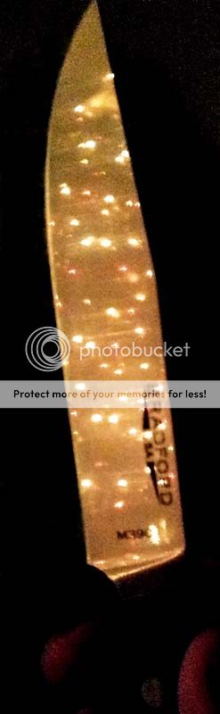

and just a little left over Christmas cheer, rough image of the blade with reflection of our Christmas tree, taken with my ipod touch.
Gatsby_Christmas_Lights.jpg~original
