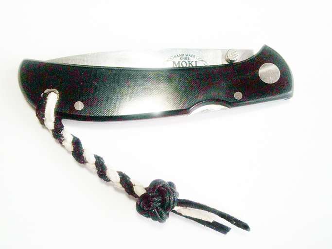

I prefer a 4-strand braid using two different colored laces. I like a more round shape to my lanyards. A dot of Barge Cement inside the braid keeps it all in place, and your idea of the wedge keeps the 'bead' in place! (I don't actually use a 'bead.' I tie a lanyard knot from another piece of lace, and use that as the 'bead.')

My bad... I didn't use a Lanyard Knot for the bead, I used a Turkshead. (Senior moment?)
The white and black braid is done with flat suede lace, and the Turkshead is done using a smooth round leather lace.
Here's a quick shot taken with my phone.
Stitchawl
Very nice - I'll have to give that a try. Just got a GEC 73 with a tube ... it needs a Fob!
It's much easier (for me...) tying a 'small' Turkshead knot or Lanyard knot using round lace. Trying to keep everything flat, untwisted, and smooth with flat lace is really difficult for me when the knot is only 1/2" or so in diameter! Round lace eliminates that problem.
