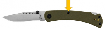

one handed open/close.Well folks, I dont think its just the TRX. I got these in the mail today and never have I ever had a 110 where I had to use some tool to squeeze the unlock bar to close the blade. One I could manage to close it with just fingers, but the other had to have a tool..
So i will work on them as you all suggested and as I have done to some in the past to make themView attachment 2104039one handed open/close.
I have loosened that screw on mine to the point there is a very obvious gap that can easily be pressed shut with your fingers and it did not lessen the tension on the lock!Pack Rat,
Here is the response I got from Buck after i send my three TRX's in for adjustment/repair/replacement. I hope it helps:
"Thank you for sending in your 110TRX’s...The arrow is pointing to the correct fastener to loosen if you would like to relieve some spring tension. I’m also sending a Torx T6 bit with your knives. There is a point where it becomes a safety issue if loosened to much. I have already adjusted them to where I felt it was safe and easier to operate.

Did you purchase your 110 sport through the website? If you would like me to take a look you can send them back to me.Mine doesn't have that screw.... Is a different model, same problem
Yes Sir I did, But I will work with them some more. Wrapped the blade in a thick cloth and saturated the insides with oil.. One has loosened up some. Thanks..Did you purchase your 110 sport through the website? If you would like me to take a look you can send them back to me.
