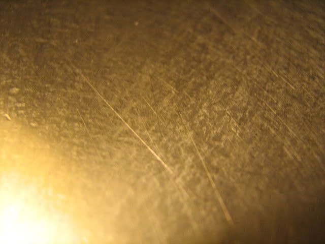

I sold the DMT EE at one time, so the level of finish quickly became an issue. I had used one, and could see the finish getting finer, but wanted to see if I could accelerate it. So over the course of a few days, I lapped it with a DMT XF stone. Here's the results using the back of a chisel...
As you can see, the stone did break in, but at a cost. It "killed" a couple of spots on the stone... the dark spots no longer contain any diamond. The rest of the stone was fine. Over time the majority of the stone gave a very fine finish.
So, to maybe sum it up... yes the stone will break in over time, and no I wouldn't lap it with a XF stone... at least not very much. You could probably get away with a little bit.... but if you kill a spot, obviously there's no going back. I would just treat it as a fine stone in your lineup initially, and move it down as it gets finer. Obviously, the time it takes to break in will depend on use and steel type, etc. I never tried lapping another stone on it. Hope this helps a bit.

Cool pics, Curtis!
I've killed spots on mine and scratched layers off, too. :( It's a good stone, but requires more care than I gave it.

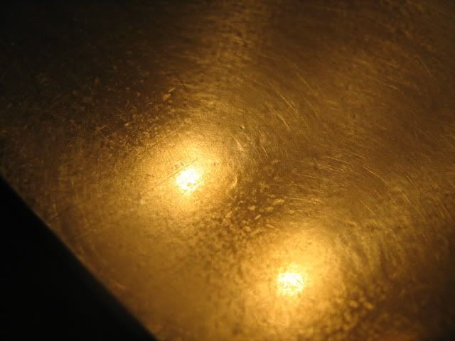

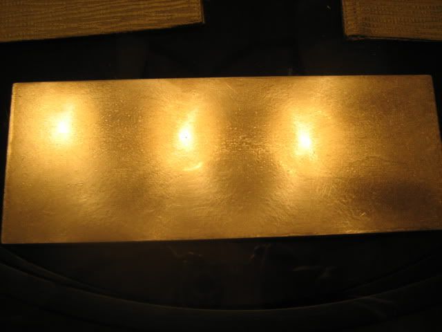

This is what a properly broken-in EEF looks like.
I don't know why the scratches are there but I think it was from when I used it on my 8000 grit waterstone for a few seconds. When I did the water started turning black so I stopped.
I probably still have more break-in to go through but the results are very good right now. The problem that everyone seems to have is they don't like the look of the edge after and are expecting a higher polish. Well the polish is probably higher than you think but because of the shape of the diamonds and the way they remove steel if your expecting a mirror polish your not going to get it, but if you understand the way they work you get all the mirror polish you want.

A Shapton Glasstone shouldn't kill it, but that black sludge coming off a clean diamond stone is definitely a sign of demise. And one more reason to seek out a W4EE if raising a slurry with the D8F (which hasn't been harmed by waterstones yet :confused:) isn't good enough. Killing a $20 doodad hurts $50 less than killing a $70 doodad.

But the way your stone looks is probably how it should turn out. The best polish I got was near the spot I "killed", which seems to be the consistency of your entire stone. That's what should be strived for, to get the most out of the stone. How long did it take to get to that point?

Its been a year but about 4 months and it should be really close to what mine looks like. The other thing that makes a HUGE difference is the amount of pressure you apply when sharpening, less pressure better polish.
