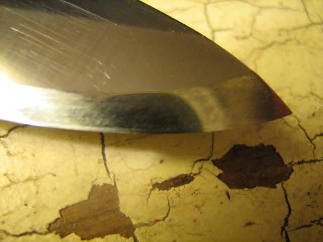

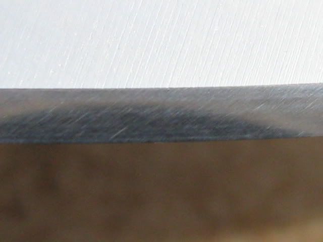

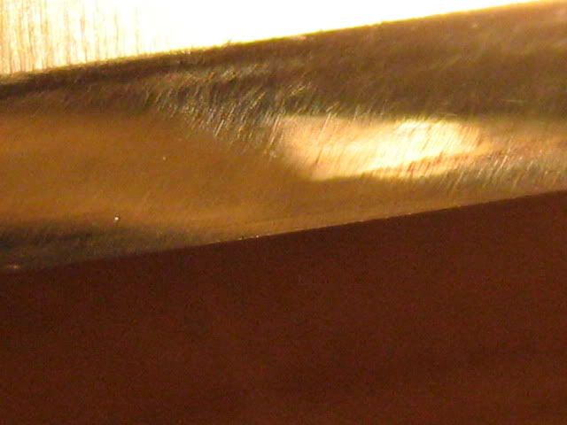

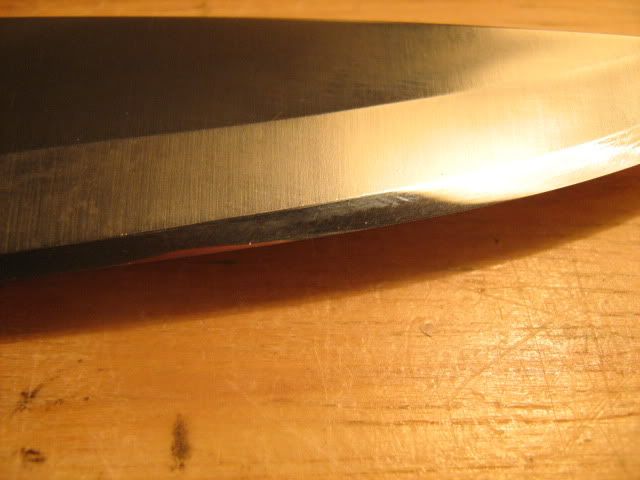

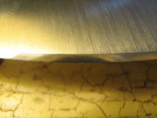

Mike, the scratch pattern from the EEF can be a bit confusing. You never end up with a perfect polish the way the diamonds cut just won't allow it. The surface becomes polished but still retains a fine scratch pattern, its the diamond edge.
The amount it will polish a given steel seems to vary a bit with the steel itself.

The last two pic's are after using soapy water on the EEF stone.
Thanks for the pics, Knifenut. I don't really expect a perfect mirror like my waterstones give me, but I am hoping for some nice push cutting with some tooth still there in my S90V Manix 2 (and whatever other knives I sharpen with it). I can always polish the backbevel and microbevel with it anyway to get a pretty backbevel and the D8EE edge finish for it's sharpness, but we'll see how much I care to polish out the backbevel. At this point I think I'll microbevel my existing knives with the pretty backbevel but on my new rebevels like I did last night on my Gayle Bradley I'll just stop at D8EE if I like the sharpness and save myself some time. I do need to keep breaking it in to get that great edge that you plan on using on most of your personal knives, Knifenut, but based on that endorsement for the performance of the D8EE when properly broken in I should really like the sharpness. On any steel worth it's salt that stone should peel off tiny, tiny curls of hair and still have a bit of slicing aggression left (unlike a no-tooth 8000 grit waterstone finish) if it is Knifenut approved as a finishing stone. On my hunting knives I might stay a tiny bit coarser, but I think on my next skinning job I'll try the D8EE finish yo see how that finish works. .05 microns was too fine of a finish to where the knife cut better after dulling and getting some teeth from the carbides getting exposed due to the pure slicing motion of skinning, and my hair whittling edge just wan't ideal. 2000 grit waterstones worked great on my 400 lb. Boar, but it appears the D8EE can give me better pushcutting with similar if not better slicing aggression, if not the mirror finish a 2000 grit Glasstone gives you. As long as the knife cuts good with good edge retention who cares about the looks.
