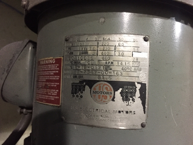

I'll take a pic of the motor plate tmrw at work. It's nice because our company purchased it new 30 some yrs ago and we just put about $3k into refurbishing it in 2013.

3 phase motors in that size range will typically be 220 OR 480 compatible. Depending on where you work, it may currently be wired for 480VAC. Make sure you re-wire it accordingly.
2HP 3 PH, 220/230/240 volts 3 amps
Nice!
Definitely going to need 220 in the garage for that, unless you swap out the motor, which can turn into much larger pain than wiring a 220 outlet.
