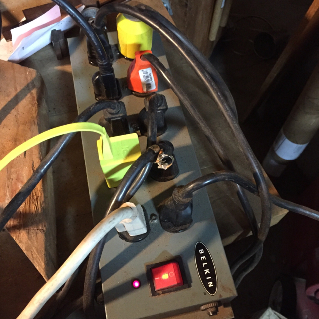

Y'all remember the rolling blackouts? It was all traced to that power strip.
That's only one of the two. I'm embarrassed to show another one :-)
It's Los Angeles. We have two fireplaces and one outlet in the garage. That's how it is here. :-)
My shop is an electrical nightmare. Our power bill last month was over $600, and the majority of that flows through wiring installed by vandals.
