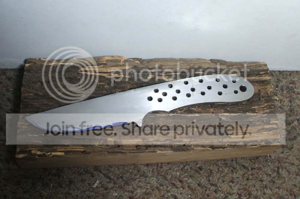

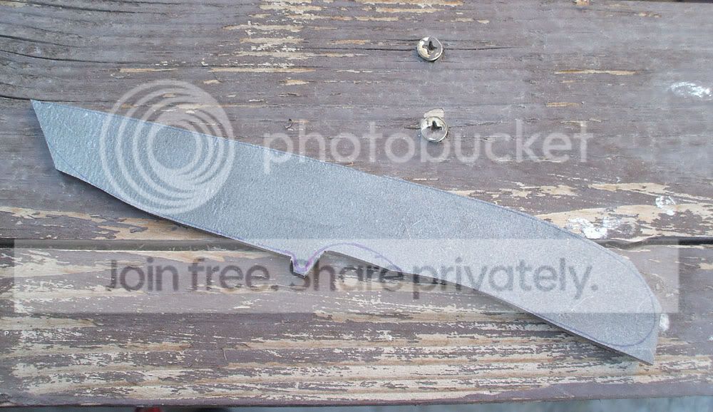

This is the simple design I came up with:
blade steel 154CM .140 thick (donated to the cause by Alpha Knife Supply)
blade length: 3.4"
heat treat: Paul Bos

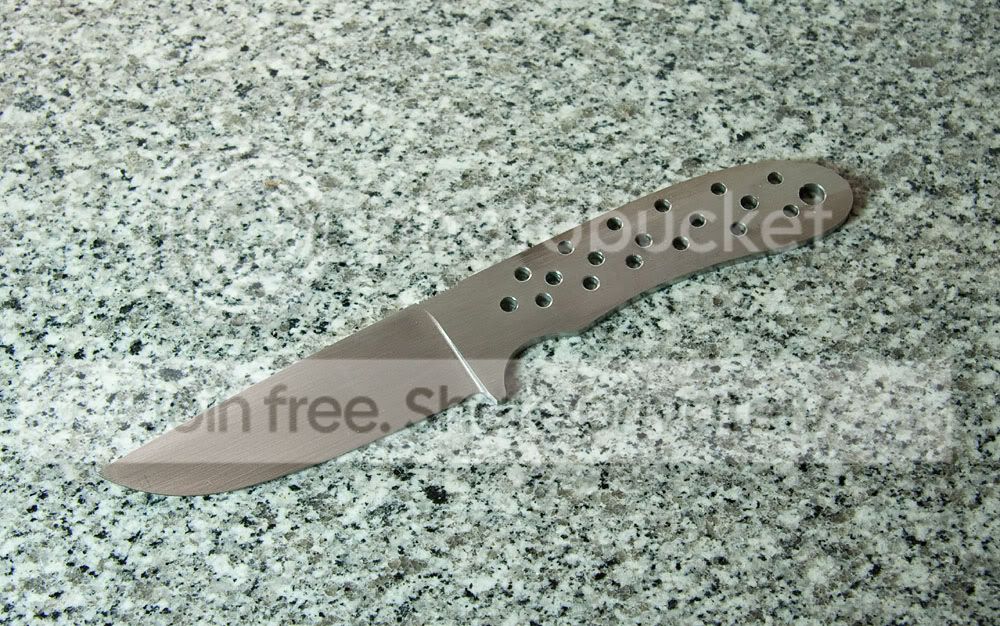

The design was drawn on thick paper ,cut out , then traced onto the steel , rough cut ( and I do mean ruff ) on the band saw , then the final profile done on the Bader with 60 grit.

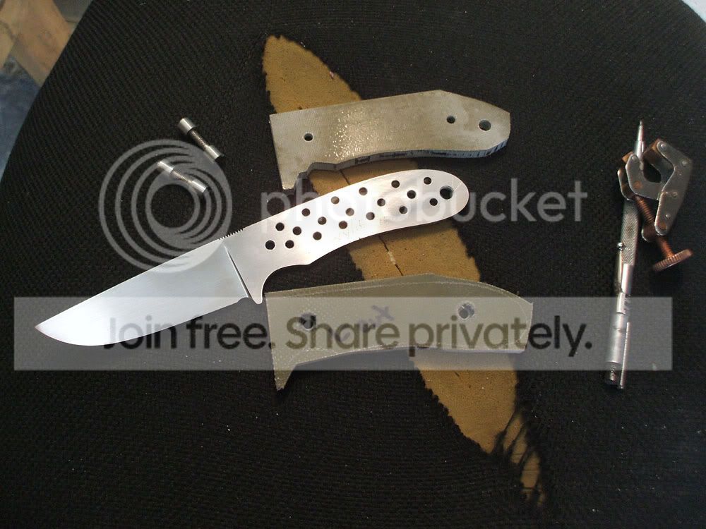

Here it is profiled , surface ground poor boy style on the flat platen and also the 9" disc. Wasn't sure if I would taper the tang or not , so I drilled many holes just to be safe .
Grinds done , jimping done on the spine with a 20LPI checkering fille , sand hand satin work done ( up to 220 ) and it was off to Paul Bos for HT.

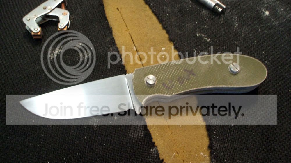

blade back from HT , hand satin to 400 grit ( sorry , that all the finer I have)

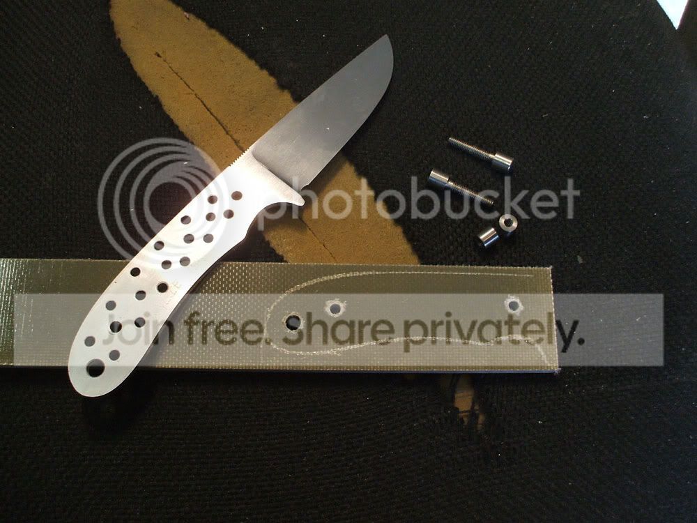

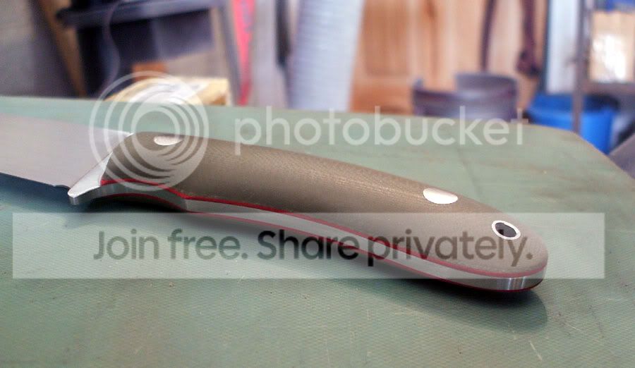

Start to work on adding the scales.

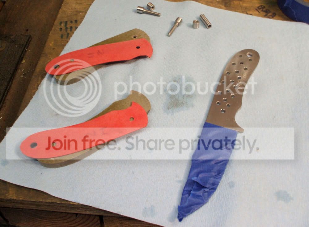

Drill the holes for the corby style bolts , scribe the profile and off to the bandsaw.
Repeat for other side and now I have a pair of scales....I have also counter sunk the holes for the bolts , which never seem to fit just right , so I turn the bolts down to fit the holes nice and tight. ( cordless drill and slack belt ...poor boy lathe )
I then shape the scales up to the scribe lines , and shape the front of the scales so they match , then do a test fit..
All going according to plan , I add the red liners into the mix and shape the front of the scales , final sand and buff.

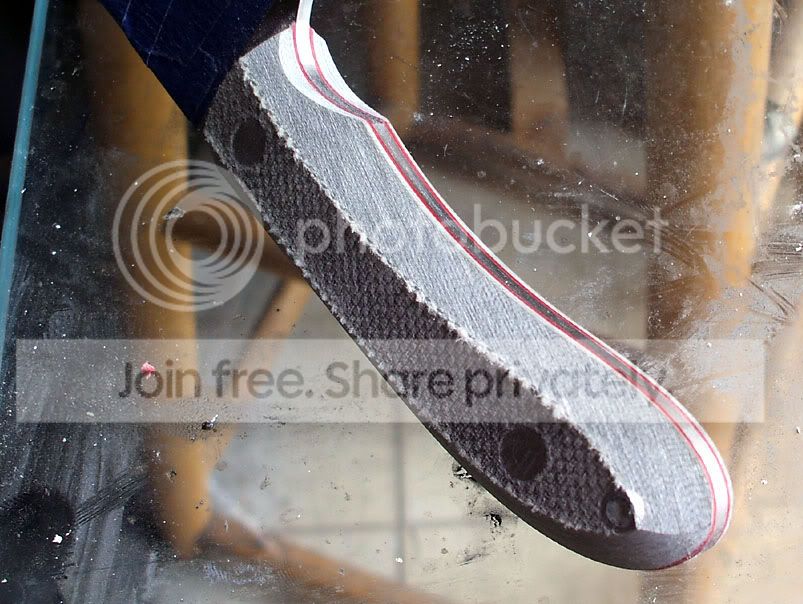

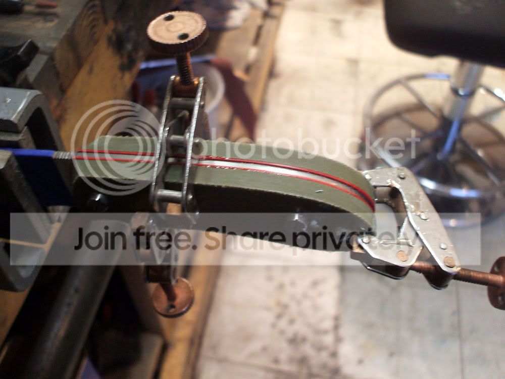

ok so all is set , cut the lan tube , test fit it , and disassemble once again , clean everything with acetone , tape up the blade...
Ready...set
Glued.. yeah the Kant twist are over kill , since the Corby's will hold it tight , but I never take a chance. With the Corby bolts the epoxy is just a sealer.

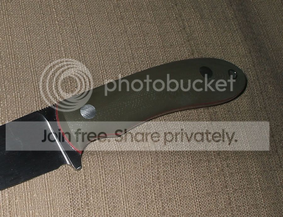

Wait about 24 hours ,then on to shaping the handle and get started on the leather sheath.
The plan is to present the knife to him at his awards ceremony , along with a photo album with pictures of the build. Hope it brings him many years of good use.

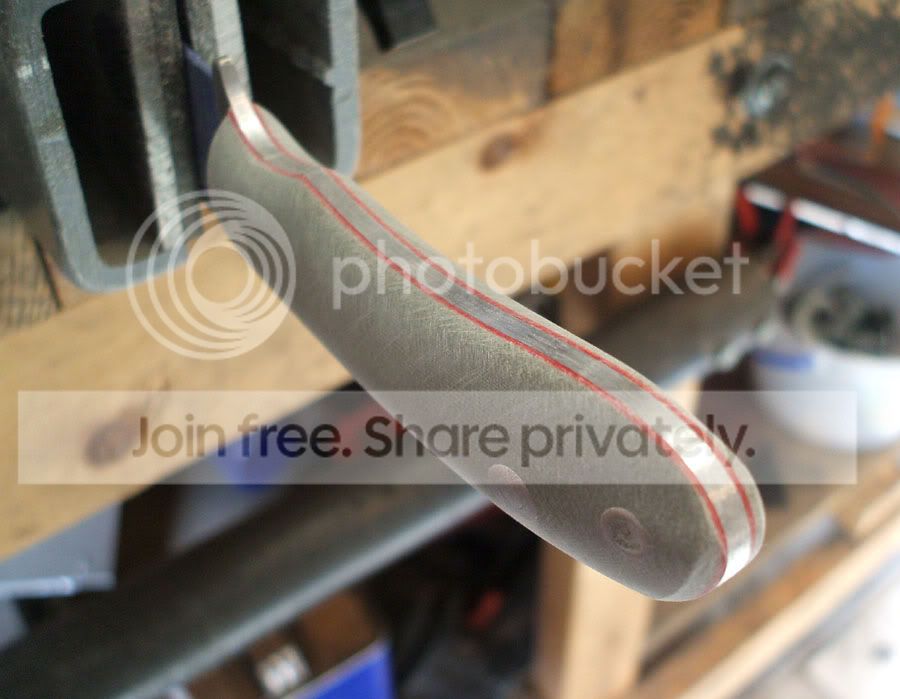

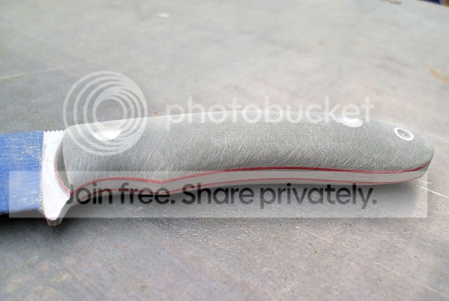

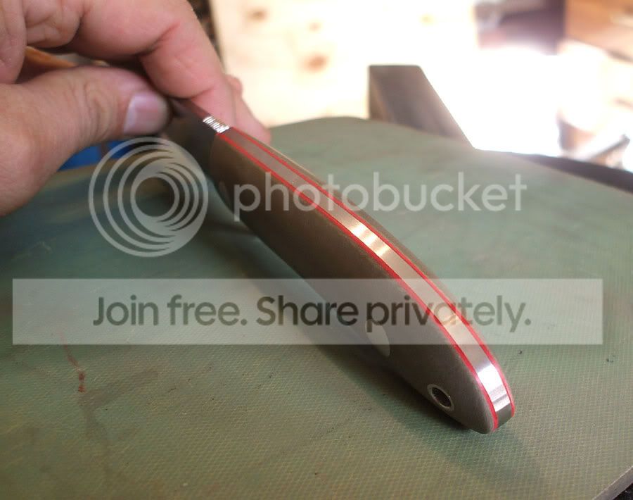

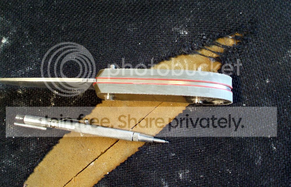

With the epoxy cured ( epoxied it yesterday afternoon ) , it was time to trim of the excess bolts on the band saw and get to profiling. Sanded the outside to shape and broke the corners to a bevel with a 60 grit. For me this makes it easier when rounding the scales on the slack belt.
Then 80 grit to rough in the contour :
From here on out , all handle work is done in the knifemaker vise using 1" shop rolls in 80 , 120 , 220 and 280 (sometimes 400).

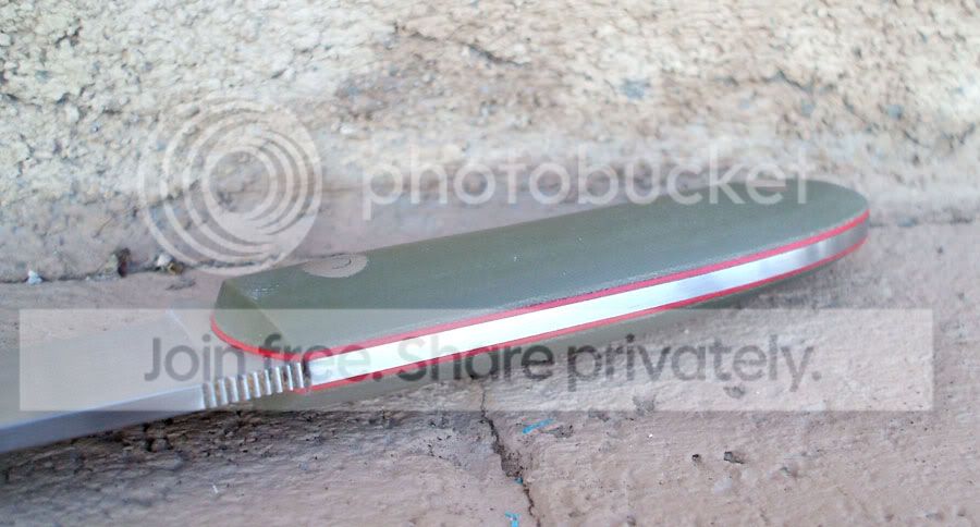

taking shape pretty nice , at 220 grit here.

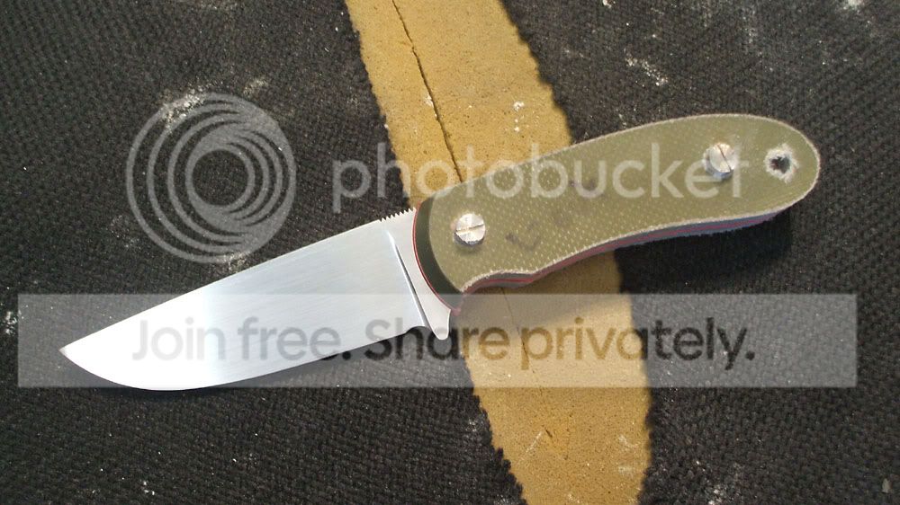

Love the effect of the red liners against the OD Green

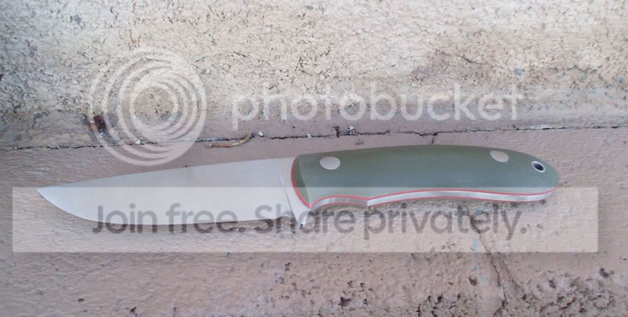

This is about it for today , will do final cleanup , logo and sharpen after I make the leather sheath:
Now to find all my leather working tools....and a clean spot on the bench to work the leather.....and get back to working on a slip joint design.
I have no clue if this is the way others do it , but it works for me , I am open to both good & bad criticism. :thumbup:

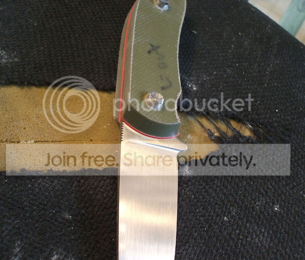

Ok, if I can ask a question here, this shows a "toward the tang" sanding of the micarta right up to the metal, but no scuffs on the metal. This is an area I am having trouble with, not scuffing the metal. What's the trick there?
Then 80 grit to rough in the contour : [IMG said:
http://i1011.photobucket.com/albums/af236/VegasBlades/EagleScout/countourstarted.jpg[/IMG]
