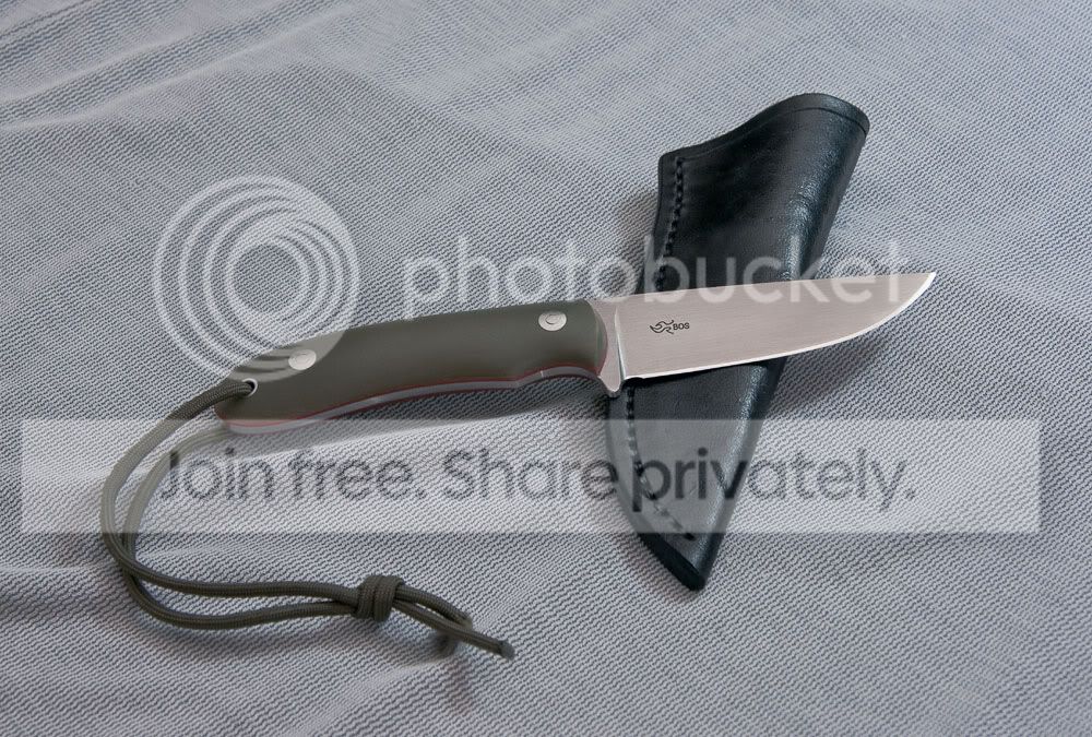

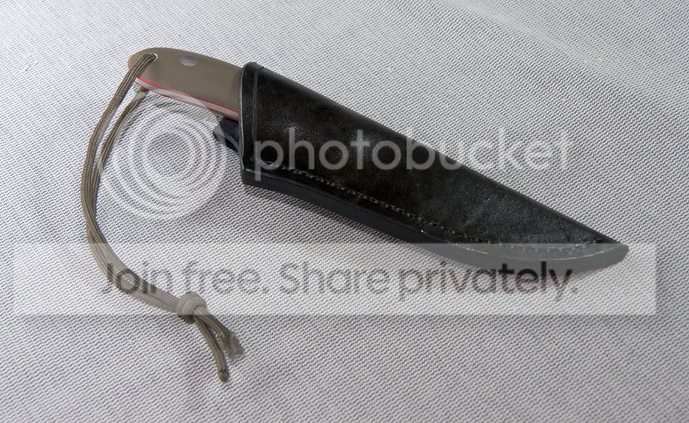

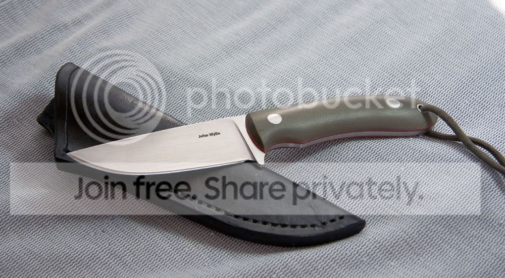

Brief tutorial - a simple fixed blade
I have on occasion scuffed the tang , but that is easily fixed , though using the " shoe shine " motion with the shop rolls , I don't have that problem very often.
After shaping the handle and I have it to final grit I will go back to 120 , 220 & 400 on the tang anyways , but usually there aren't too many cross scratches to remove.
...the bolts , which never seem to fit just right , so I turn the bolts down to fit the holes nice and tight. ( cordless drill and slack belt ...poor boy lathe )
I've had to do similar fudging on a couple re-handle jobs. Didn't care to redrill a hardened tang so I turned the the bolts down to fit the existing holes. I just chucked 'em in the drill press and gently held a file against them till they fit. I worked real slow because I was afraid of knocking the chuck out of whack. A proper machinist would likely cringe at the idea, but it does work. I've come to really like Corbys. One client wanted removable scales so I just cut the slots deeper, so he could grab 'em with screwdrivers if needed. Worked out nicely.

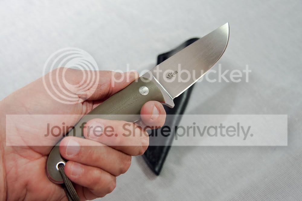

Love the tutorial. What thickness were the scales before you sanded?
I sure would be proud of receiving a knife like that if I was an eagle scout!
That is a very good thing you did there. Once I get to a point where I can do something like that I will be happy to pitch in for the locals or even help you out with some supplies. Been a rough couple of years for me after the Aluminum plant I was working at shut down so it might be a while until my feet are under me all the way again, but I start at the Montana Resources mine here in Butte in about a month or so and I love doing stuff for the kids. Before I went to the plant I was a manager for 13 years in the newspaper industry and I would hire a lot of kids who had done something stupid and got it trouble with the law. Tried to help them see where their lives where going to end up if they did not start walking the line, sadly, more of them still thought they knew it all and ended up back in jail or worse prison. Out of the over 200 of them I hired, only about 20 of them took what I said to heart and are still out in the community working and having a life. Very low percentage of success and a lot of heart ache to see them screw up worse, but at least I was able to help a few. Had to move on to a better paying job though to support my own 4 kids is the only reason I am not still doing it. So I would love to help out.
Very nice knife to by the way.
Ronnie
Zaph1: What is do is always sand/shape/grind the front part of the handle where it meets the ricasso BEFORE I glue it up. I use the handle bolts to hold the slabs together (or clamp firmly), without the blade between them, then work it on the grinder or hand sand until I'm satisfied. It might take two or three times to disassemble and look at the slabs on the knife before I quit. No danger of nicking the blade this way.
I believe the material was.250 or just a tad thicker.
same here , sure it takes a bit longer , but it so worth the extra effort. I don't much care for the look when the scales just end with no bevel at all.
