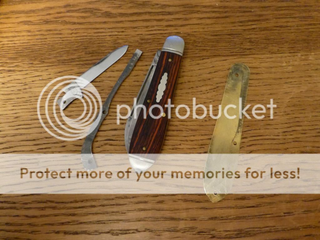

Here's a picture of a #85 I removed the pen blade on.

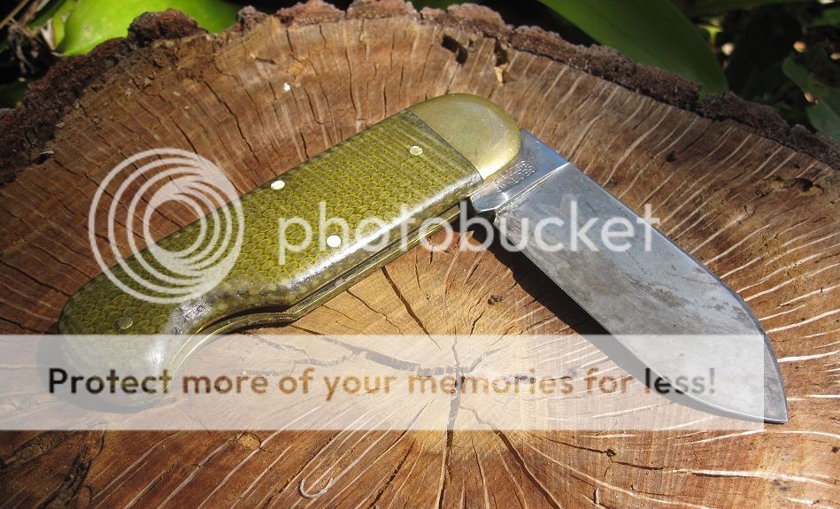

I will show off a couple of my modified traditionals (all done by esnyx, of course):

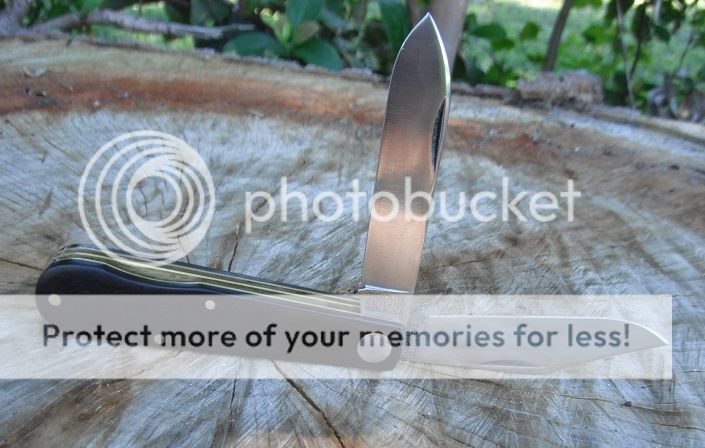

I wouldn't know what future tutorials to ask for, but I'd love to be considered for the giveaway. Thank you for the opportunity! I haven't modded many knives, but here's the one I did:
I modded my GEC 85 to have an easy open notch, and turned the pen blade into a coping blade. It's not all that involved, but I was proud of the results!
