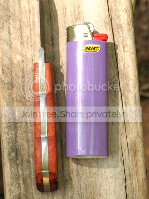

I was wondering: does anyone have any photos of the knives with fit & finish issues they've had? Because that would help make it clear just how bad the issues are, since as I said in one of my earlier posts, some people are pretty carefree about fit and finish, and some consider even the slightest imperfection a fatal flaw.
Here's a picture of what I'm complaining about, thats like at least 5% of the edge left unground.

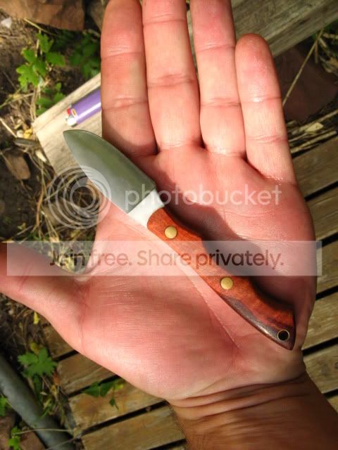

Sketchbag, that is supposed to be that way. Here's a pic from DLTTrading showing the Micro Canadian:
The unsharpened area in front of the scales isn't supposed to be sharp. That's the ricasso area, and it is designed that way.
Andy

In my opinion, cosmetic fit and finish flaws like those in your pics, apsilon, are rather common in a wide range of knives from many and even most manufacturers, from $5 cheapos to $400 customs. Certainly not the rule, but, common. Uneven guards and non-horizontal grind lines in handles or pommels in particular are very, very common. None of those flaws are the kind that would seem to affect performance, but I wouldn't want flaws like that on a blade that was intended as a collector's piece. Serious fit and finish issues, but luckily not harmful to performance in use, it seems. A lot of folks would just ignore those and say that a knife left like that has "good fit and finish", because the edge was usable and the knife stayed in one piece. Me, personally, I wouldn't mind if it was going to be a hard user, but I would not accept fit and finish that poor if the knife was meant to be a collector's item. To take another manufacturer mentioned in the first post, Fällkniven, into consideration, Fällkniven's knives have a lot of cosmetic flaws somewhat like this that many people don't even consider flaws because they do not affect performance. I guarantee, for example, that if you take a 100 randomly selected Fällkniven knives, you will see many where the tip is clearly unevenly ground, the protruding tang butt on the knife is ground very unevenly or has been left very shallowly protruding. They're common flaws in Fällknivens, but not the kind that would prevent me from buying and recommending Fällknivens as user knives.
On the other hand, the unsharpened part of the edge in your pic, sketchbag, is the worst kind of fit and finish flaw: it's cosmetic and also very detrimental to performance, since part of the edge has just been left out. Flaws like that are much less common than what was seen in apsilon's pictures. It's a very bad flaw, and in my humble opinion, is cause enough for most people to return the knife for warranty work or more. I know some people who wouldn't mind, though, and some that wouldn't even notice and would still rate the knife as having a good fit and finish. :eek: I have seen flaws like that on quite a few knives from a variety of makers, even on non-cheapo knives, but those kinds of flaws are really serious. If I see flaws like this commonly in a manufacturer's blades, I will not recommend them or buy them.

I have one barkie, and the fit and finish are fine. Not absolutely perfect, the hand work on the scales and tang are obviously out a bit if you have knifemaker eyes, but less than you could measure without a 3 signifigant figure digital micrometer, and far less than you can feel.
Overall I'd rate it equal to or better than any other good quality hand finished production.
HOLD THE PHONE!!!!
Sorry to yell, but the "flaw" that sketchbag is talking about isn't flaw at all... that's the way that particular knife is designed.
Andy
Huh... what??
