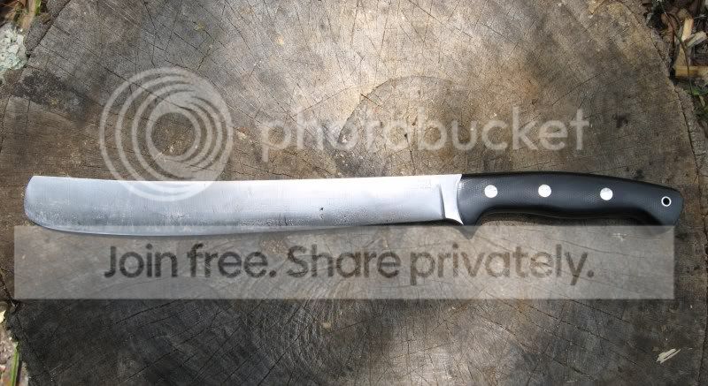

I love my BRKT Golok. It has become my favorite knife for yard work and would be a superb camp knife. It chops way out of proportion to its size and weight. I accidentally dropped it in my burn barrel once, and fished it out before it got too hot to mess up the heat treat, but the "barrel fired" micarta handles never looked quite the same. So I got a new one.

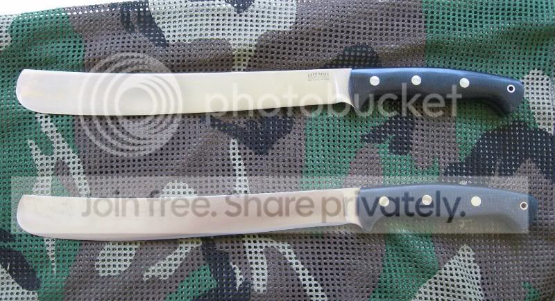

Having a new one for back up meant I could take a chance on a modification to my old one I had been considering for some time. How cool would a pointed BRKT Golok be?

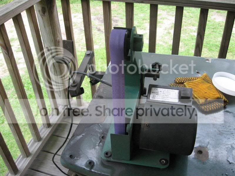

Here is my state-of-the-art belt grinder. Finest in all China for $30.

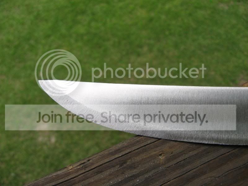

I went through 3 80 grit belts just to get this far.

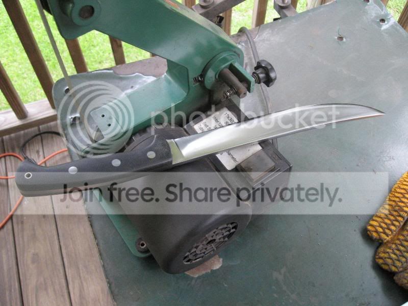

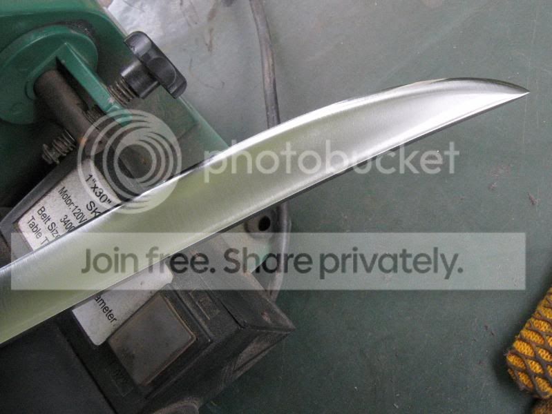

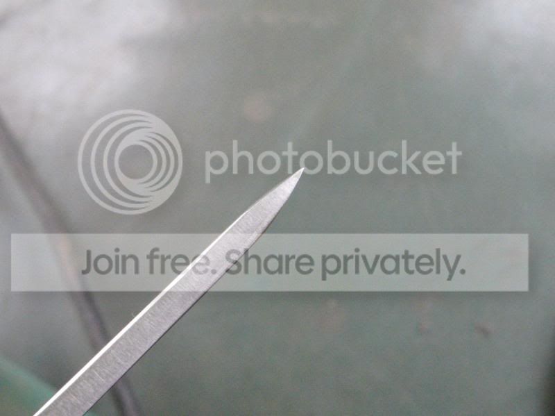

Coming along nicely. I had drawn a line with a sharpie as a guide to the new profile. I had to thin the blade toward the tip to make the point look right.

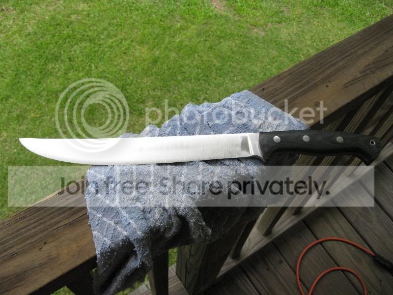

I think it came out pretty good.
Here it is between the golok and Bay De Noc. I call the new pointy golok (not a golok anymore) the Satilla Scimitar camp knife.

I like the BDN fine. I got mine on close-out from DLT. But it is not like a golok with a point. It is much lighter. It is basically a camp carver or even a fighter, very light in the hand. It can do light chopping and batonning, but it is not a heavy camp knife.

The reground golok lost an ounce and the balance point moved from about 1.5" out to the choil. It is not as effective a chopper as it was, but still better than the Bay De Noc. And it can stick things!
