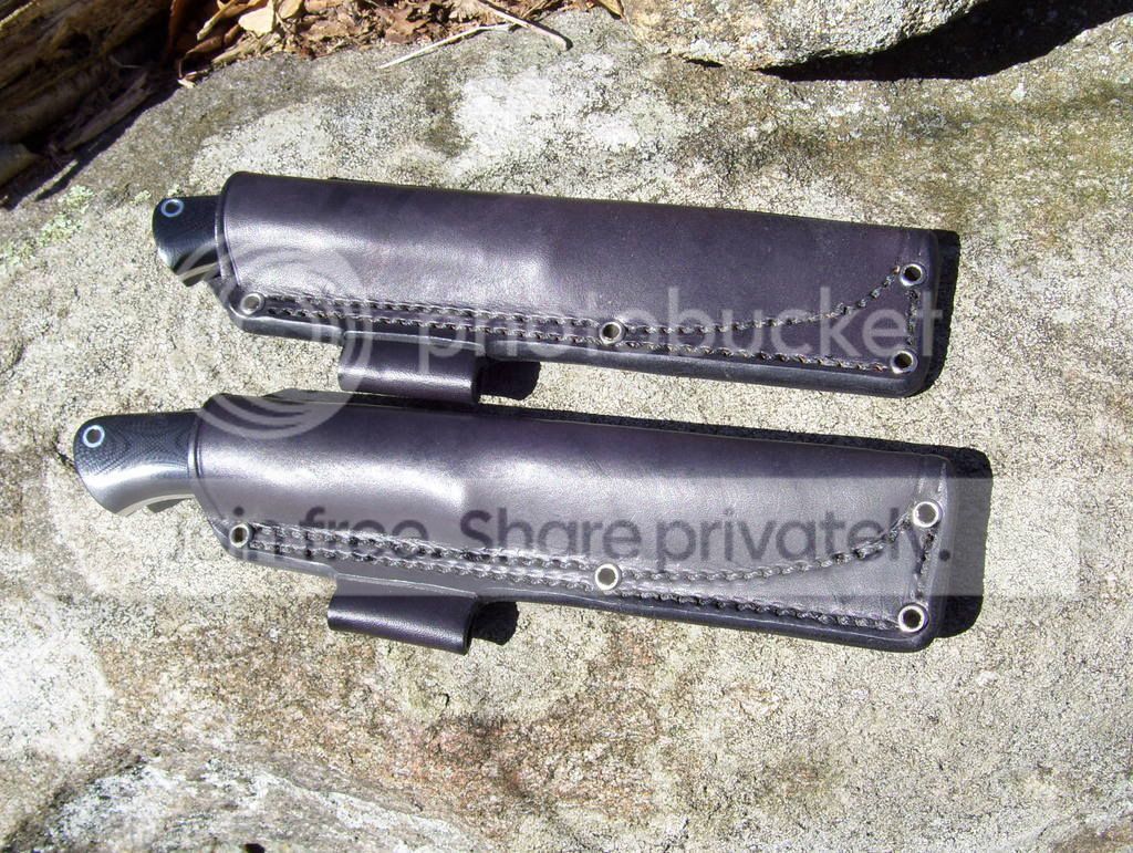

Both knives arrived on my doorstep finished with polished black linen micarta handle slabs and solid pins. They arrived shaving sharp with customary Bark River Knife and Tool convex edges. Each was carefully packed as is standard with Bark River Knives with cardboard edge protectors in individual boxes with packaging peanuts and plastic bagged sheaths. Both knives arrived with supple black leather Sharpshooter Sheath Systems belt sheaths. The HCF proto 1 fit very deep in the sheath with less than 1” of handle sticking out while the HCF proto 2 was a snug fit with more handle exposed. The HCF proto 2 handle molded itself in the sheath and seemingly “snapped” secure each time it was resheathed.

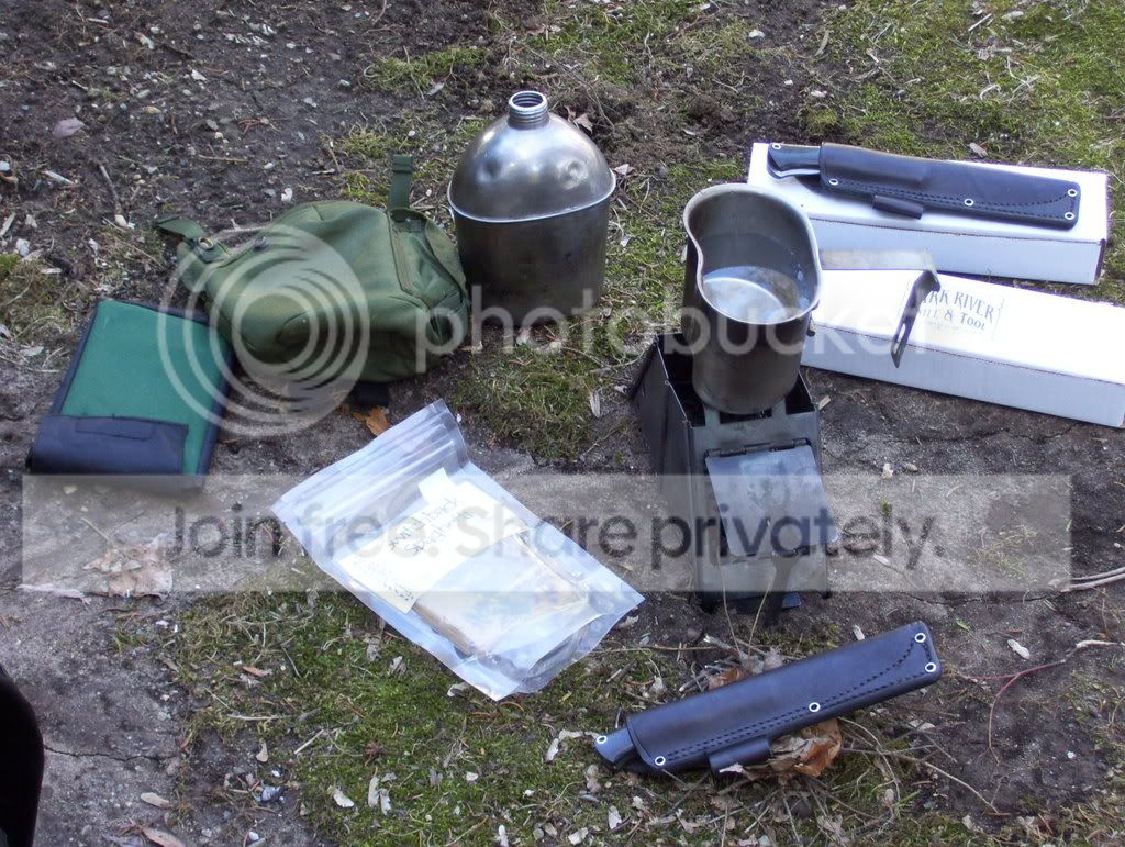

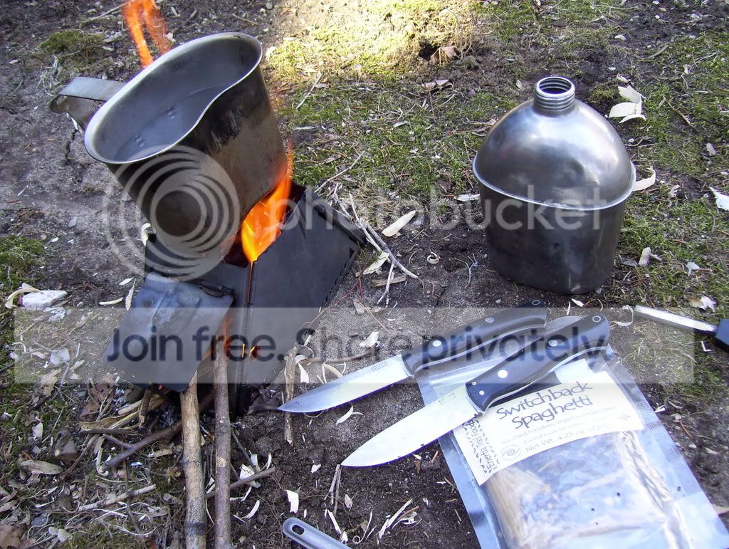

The field testing for this knife included hardwood battoning to create fuel for a pocket cooker. This handy stove is one commonly carried by hikers and campers that prefer an economical way of boiling water and warming food. While small twigs, leaves and kindling can be used, hardwood is a better choice as the heat output is greater, burn time longer and the coals are more substantial. The HCF Prototype knives performed flawlessly. The winner in this case is the HCF proto 2 as the larger more robust handle was easier to grasp and control while striking the blade with a baton.

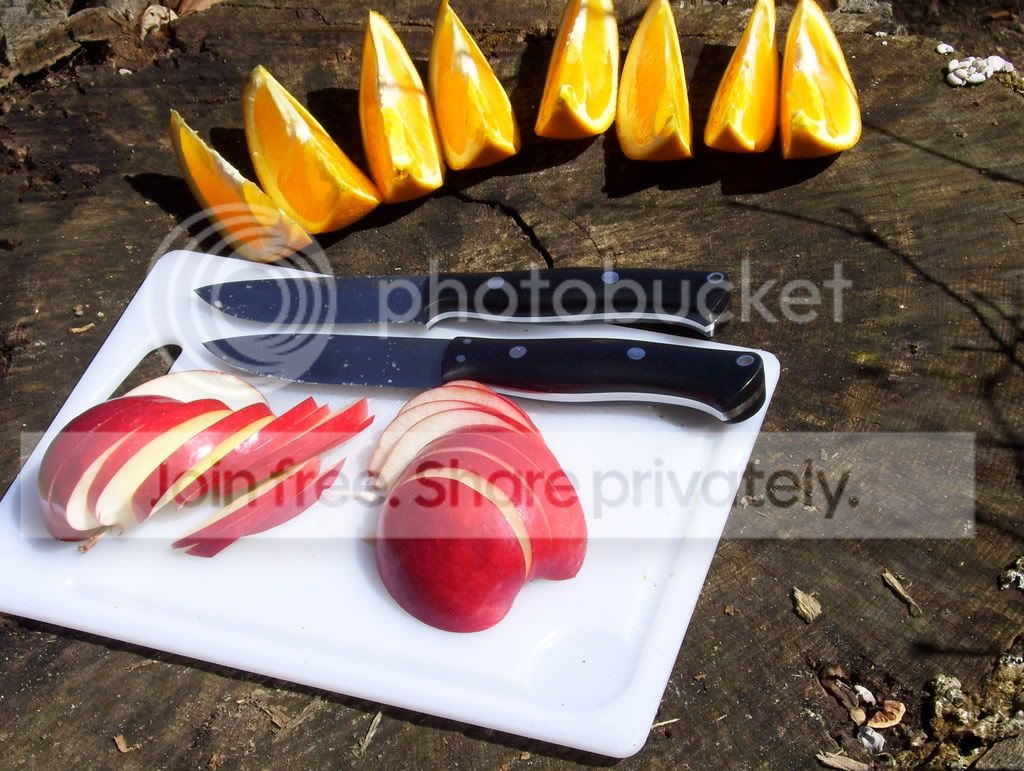

Testing and evaluating cannot be done on an empty stomach; both knives were employed in food prep duty. Each knife has a life and personality of its own in backwoods kitchen duty. The smaller HCF proto 1 handled like a larger sturdy bird and trout knife while the HCF proto 2 acted like a heavy duty utilitarian blade. Both knives sliced effortlessly thanks to the superb edge geometry standard on all Bark River Knife and Tool Products.

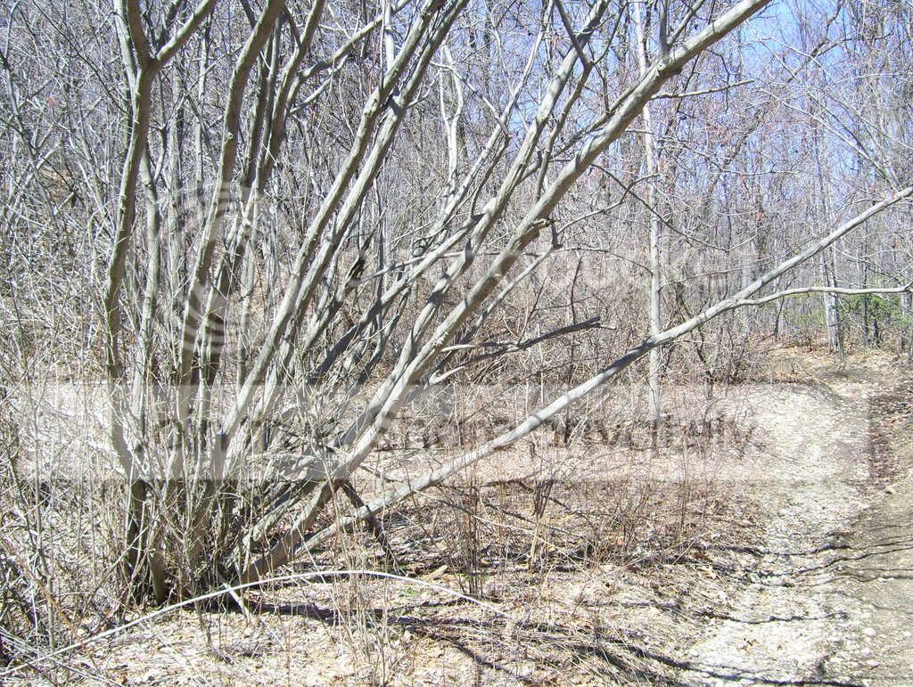

Camping and hiking are two pastimes that can and usually do lead to learning about outdoor survival and bushcraft skills. Knowing this, I wanted to test both knives’ ability to perform common tasks the bushcrafter and survival skills practitioner may use on a regular basis. I found a nice cluster of ironwood and since it was tucked away and plentiful, I took a piece for a hiking staff. I used the HCF Proto 1 to cut the staff by bending it at its base and pushing the knife through the stressed grain. No problems!
