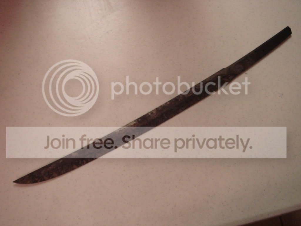

well i cracked the wak in HT... :( yeah.... 20 hours down the tubes as well as my last bar of 7/8" W2
did an interupted quench in water (water was at about 130 degrees before quench) and the steel was the right temperature (or pretty darn close)

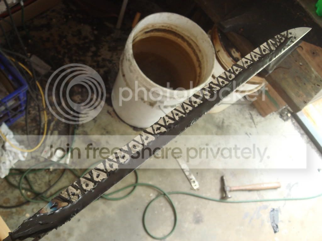

WHY DID IT CRACK?! it cracked along the edge about every 2 inches. got some nice sori on it though. it would be really pretty if it wernt cracked. sigh. any idea how i can do it right next time? can i get sori in Parks 50? the only reason i quenched in water was so as to get some nice sori.
i am needing help. oh and could it be how i am applying the clay? i was trying to get a choji hamon.. did i clay it wrong? i used Black furnace cement (recomended by Rick Barrett)
thanks for your help... God knows i need it

All I can see in the photo is that you might not have brought the clay far enough down the blade toward the edge. Might not have made any difference, just an observation.

Your blade needs to have at least a 1 mm thick edge.
Your coating would be better if more uniform in thickness. About 2-3 mm thick everywhere.

okay... blow by blow. i clayed up the blade like you saw hoping to get a choji hamon, and waited for it get dusk so i could see the color better. so i boiled all this water so that i could add it to the quench bath to get it to 130. so i had everything in place. heated up the forge.. my HT forge was shorter thant he blade so i have to move it in and out to get the who thing treated... so it was harder to keep track of the heat. i had my pyrometer going and i tried to keep it about 1400-1450 ... anyway... got it all up to heat kept it there for about 5 min. and then i took it out hold with Visegrips. and put it in the water edge first. in for the seconds out for thre.. i counted out loud. it was awesome to watch the curvature form... kinda funky. so it ended up with that beautiful sori and it didnt warp at all. so i took it in and immediatly tempered it at 400 for an hour... and then checked it for cracks... yeah... there were alot of them.

Well, you seem to have done it as good as possible.
You can sometimes shorten the sword and/or grind back the edge if the cracks don't go far. You may not get a great blade this way, but you can often finish it and make a wall hanger sword or tanto . If the cracks are very small and fine, you might want to try and finish it to see what you get. ( ? new Ebay ad - 1000 years old samurai sword, slight age cracking.)
