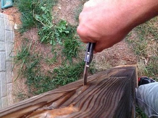

Ok, so I had a Protech Integrity folder, with an S35VN blade. I tried to adjust the lockup and ruined the knife. So for the heck of it I decided to see what it could take. It was the same thickness as the sebenza. It took a rediculous amount of lateral load before it broke. I made a thread in a different forum. I will try to find the pictures of what it took. My point is that with Chris Reeve's quality control, I highly doubt there was a defect in the blade. It had to be abused.
So as you can see the blade took a pretty good bend. In the picture you can see that I had to brace me knee on thewooden post to even get the blade bent that far.
Here is my actual post...
"I have a Protech TR-3 Manual folder that I really like. Its kind of a poor man's Sebenza. Its 1/8 inch thick S35VN and I am not sure about the rockwell rating. I decided that I was going t smooth out the action on it. I polished the flats of the "tang", the washers, the pivot and the insides of the handles scales. Put it all back together and the action was much more smooth. The lockup on my knife was always early and a little sticky. feeling brave, I decided the best way to make the lock up a little deeper (and hopefully less sticky by allowing more contact between the lockbar and the tang)would be to remove some on the metal where the spine side of the tang meets the stop pin. LESSON LEARNED> this method works well, just do NOT use a grinder to remove the metal. Took what I thought was enough off. Didnt seem like much. maybe 1.5-2.0mm. TOO MUCH. the lock bar moves all the way across the tang and now there is up and down blade play! WELL F ME. Aint no putting metal back on.
I decided to do something I have never done before. Intentionally flex a blade on a really nice knife to see how much it takes before breaking. 1/8 stainless with a bayonette type grind. Figured it wouldnt take much. HOLY S was I wrong. S35VN is amazing. First I throw the knife at my fence over and over. I got some good sticks too. No chipping. Then I started throwing the point into my rocky Maryland clay dirt. No chipping but, significant dulling. Which I would expect. There were about twelve throws at the fence and twelve at the ground.
I moved to the 6x6 posts that hold my deck up. One has a nice split. I wedge the blade in about 1.5 inches. I gently pull. It doesnt even flex. I pull harder. It starts to flex. I brace my knee on the post and pull really hard. It flexes alot and I can hear wood fibers splintering. I keep pulling for a few seconds to snap the picture, increasing the tension the entire time and then let off. I go back and forth, left and right, a handfull of times. I can not break the blade. I go to a shallower crack in the wood and keep the same test going. Same result. After about 3 left bends and 3 right bends, I really lean on it and bounce. POW! It was surprisingly loud. It broke about half way between the tip and then thumbstud.

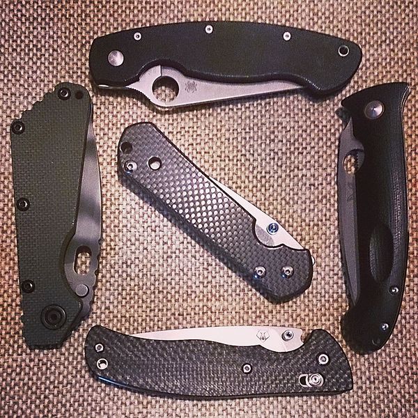

Thank you all for your attention to the topic.
With knives handled very carefully. I have many different knives.
My favorite five:
Testing for hard use knives I do not do.
Blade really broke from a small lateral load.
Details are very difficult to write. I do not know English so well on.
I'm afraid that you will understand me wrong.
I created the theme to share about the quality of service CRK.
At the moment, I am very pleased with the quality of service.
I was willing to pay $ 135 for a new blade and $ 18 on the new screws and plugs.
But Chris is completely renovated knife under warranty!
It is worthy of respect! I did not expect this.
