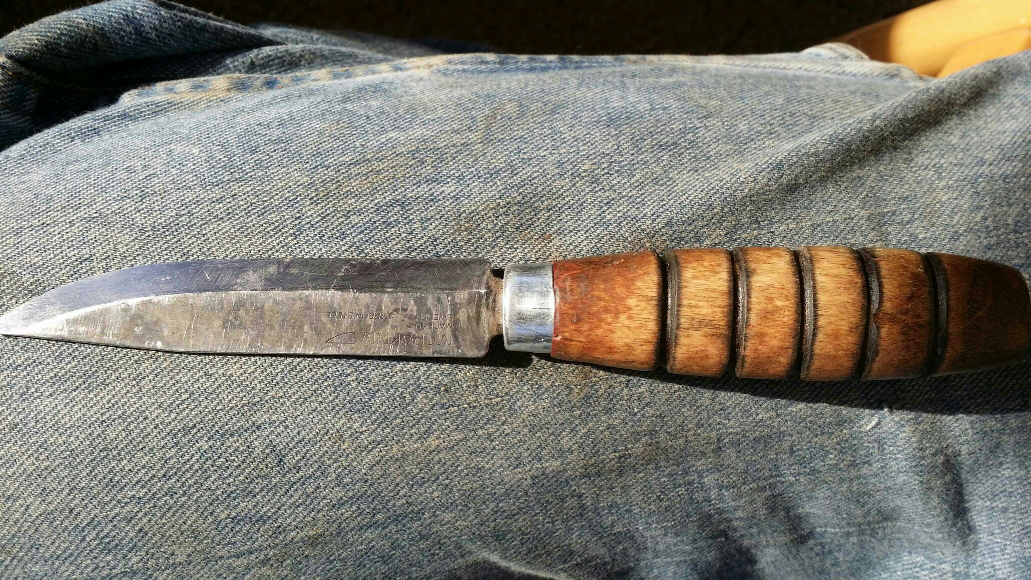

Today I was cutting through some caulk on the kitvhen countertop in our newest rental home, silicone I believe but you can never be sure if things were done properly. I was pull cutting with two hands, and had the blade sunk in the caulk while cutting. When I went to pull it out, the blade came out ~1/4"
I've only had play for a few months, and I do use this hard, but since my birthday is this week I'll be getting a HighQ Electrician for work, and put this one out of service until I can fix it. I haven't found any threads discussing fixing this problem though.
Any and all help is appreciated. I have done more than put this through its paces for three years, so I'll be sure to buy more.
Connor
The rat tail tang is just pulling out of the handle. I'd probably just pull it the rest of the way out, put a little epoxy on the tang and shove it back in there. Put the blade in a bench vise and work with the handle, be careful!
Thanks shooter! I'm gonna bundle up and go out to yank it off. I'll let you all know tomorrow how it handles the caulk after a resetting in the handle.
Connor
Well, I couldnt get the blade out so instead of epoxy I simply hammered it back in tight. No play or wiggle after a days work yesterday.
Connor
