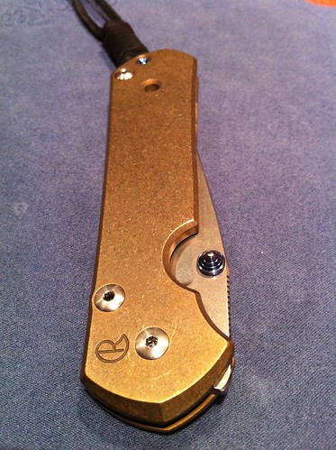

Well, I did it. I'm a modder - just can't help but tinker with things and make them my own... Read everything I could about anodizing, watched some youtube vids and built my own anodizer using a $40 variac off EBay.
Here it is. I like it. Maybe I'll get another one and try a sky blue... Better pics outside in natural light tomorrow....

Nice and even color... looks good. Almost looks like your seb was dipped in gold.
Well done! If you have good results with the blue I'd totally give you some $ to do one for me. The blue one on the thread that initiated this one looks really nice.
I've always wanted to see one anodized to match the blue thumbstud.
That's my next project. Scotch-brite the handles and then go for the blue... I'd like to try it on a small sebenza. Does anyone have one they'd be willing to donate to the experiment? :D
Wow. That is beautiful!

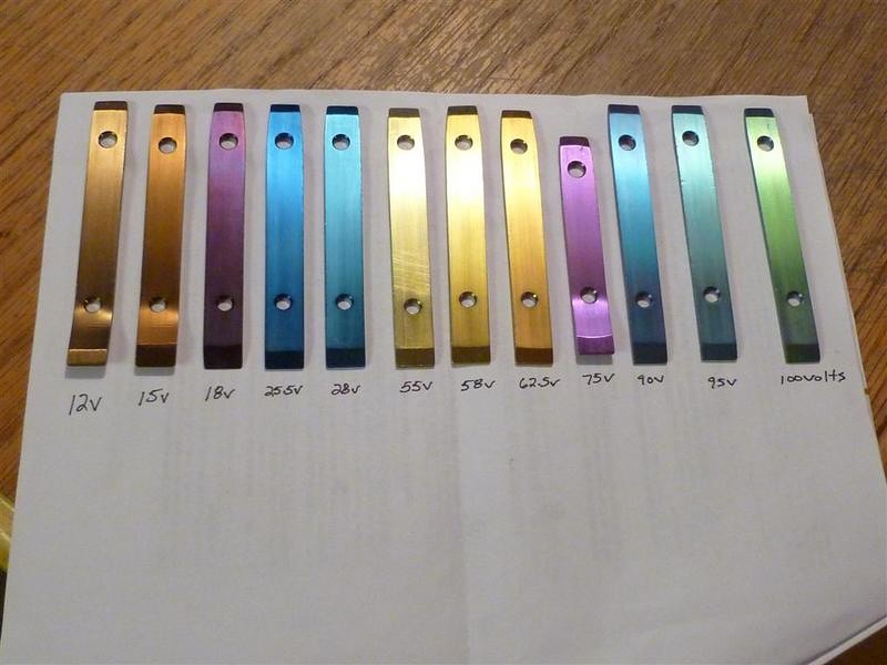

Oh, of course, you'd get it back. I am pretty confident in my technique which does not involve double dipping or doing 1/2 the scale and then flipping it over to do the other side. The whole scale goes in and get's done in one process. I have a Variac that controls voltage in 1/10 increments so I can be very exact and perfectly reproducible. The only unknown is that I haven't tried blue yet. My ideal would be what you see at the 25.5V.

Is the 90v more of a green than a blue?

Looks awesome! One thing I like about bronze over a darker color like blue is scratching shows less. Throw on top your stonewashing, and I bet it's very durable.

Thanks. Anodizing in a rainbow pattern is certainly possible although in a limited spectrum. Take a look at the chart I posted. My Variac only goes from 0 - 30V (The 100V ones were WAY expensive (like in the $400 range for DC output which is what I bought instead of having to use a rectifier for AC output). Anyway, I don't have the power to go to the yellows and greens. I don't know what splash anodizing is so I will have to check that out. I have also been toying with the idea of using rubber cement to create patterns on the handle, like zebra striping, and then anodizing blue onto the handle. Bronze and Blue Zebra striping. Would that be cool or gaudy?
