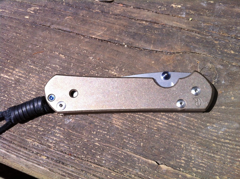

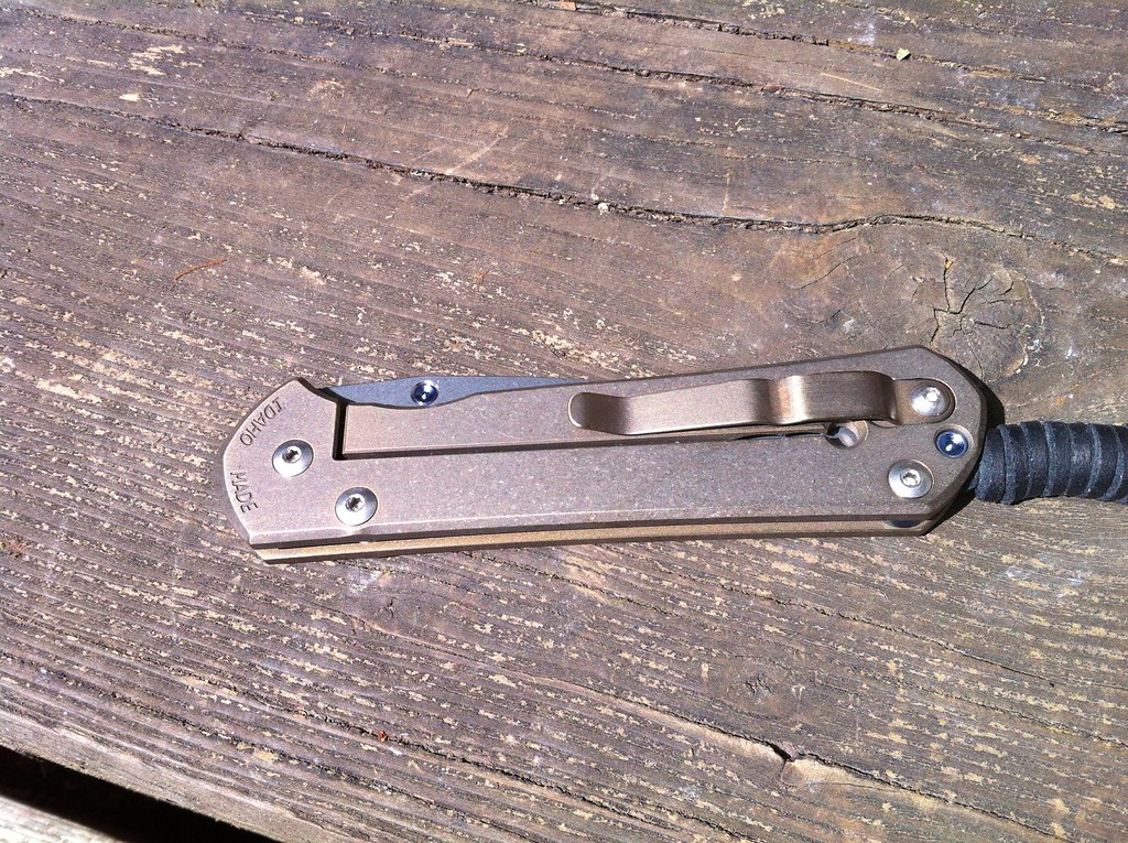

These photos are much more accurate of the color compared to my original post which was in my office and poor lighting... A cool effect is that the color of the bronze changes as it's handled depending on the oil on your hands so the finish is kind of ever changing... Really beautiful to me...
