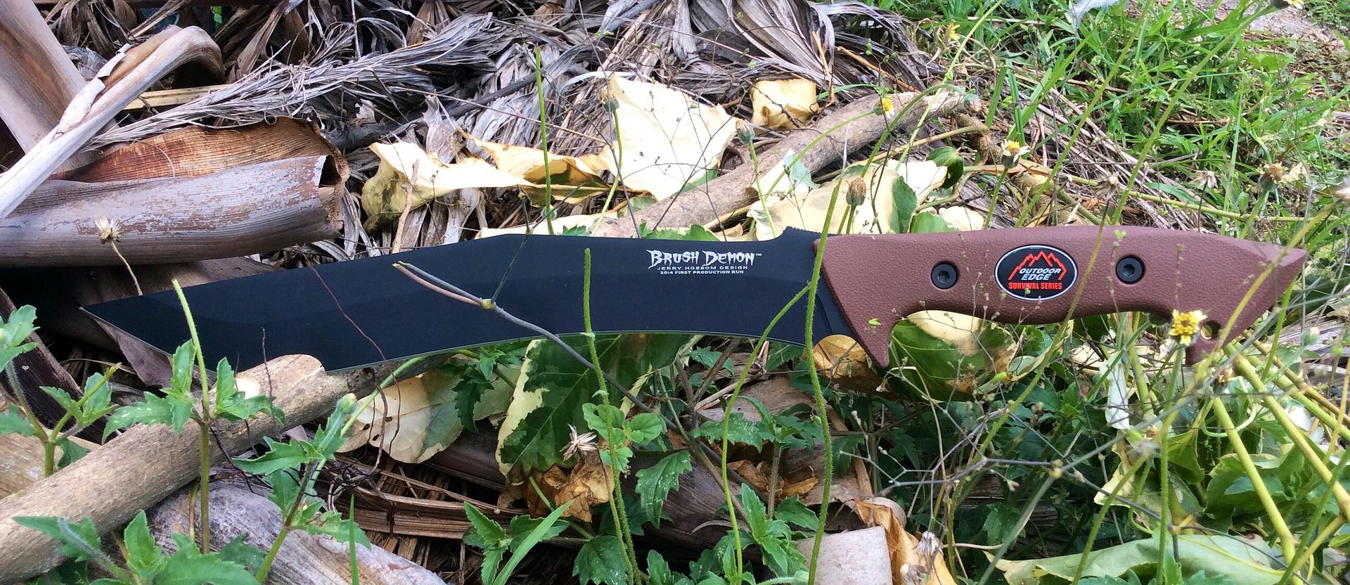

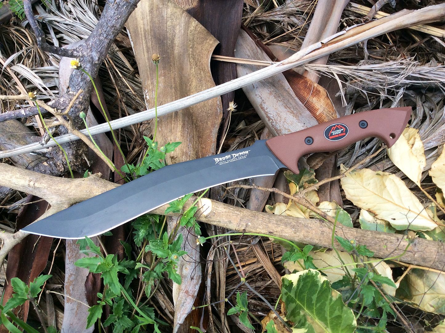

To the naysayers who were criticizing based solely on pics, this thing slices so cleanly it almost scared me. I may never go back to a standard machete again. It's uncanny. I did clean the blade after use so it looked nice for the photos again. More soon.

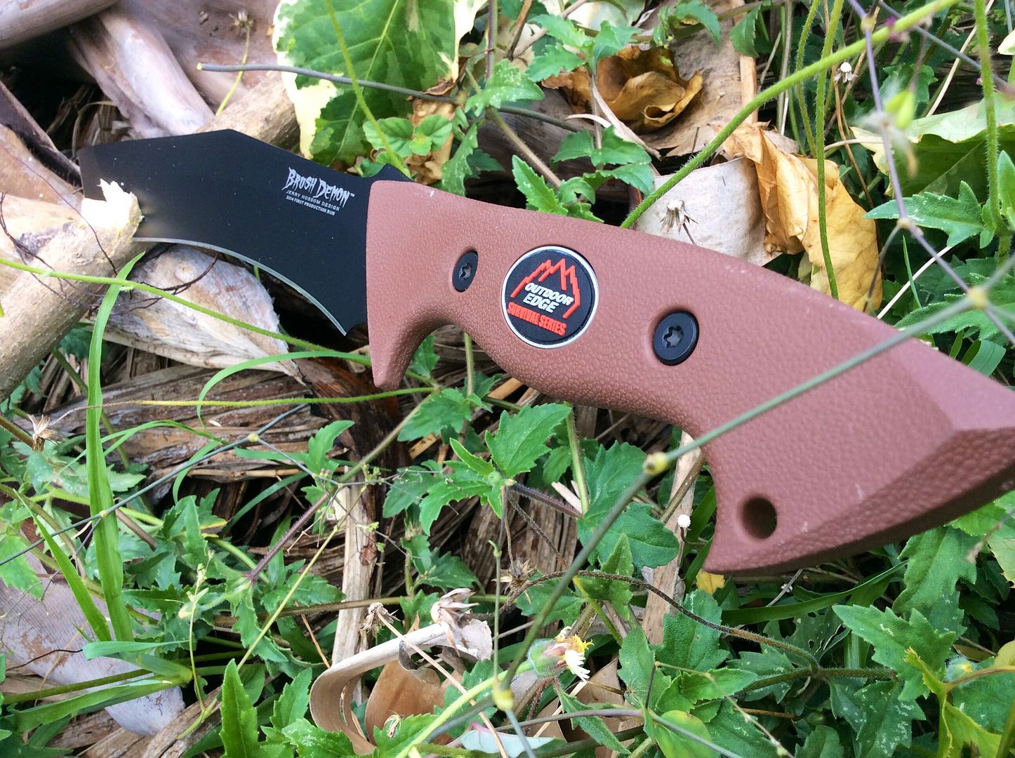

The handle is the same as that on the Brush Demon. Same steel and edge, just different blade geometry.

The balance point is just in front of the thumb ramp. It's a handy knife for one with a 10" blade and whether you choose it or the Brush Demon probably depends on how much brush and limbs you plan to chop in a day. The Bowie makes a pretty good camp knives, paired with a folder for the little stuff. It would be a great knife to have behind the seat in a pickup for whatever comes along, and it rides easier on the belt than does the Brush Demon, simply because it's smaller. And like the Demon it has a very serviceable convex edge that I've been pleased with. It holds up well, is durable, and the 65Mn steel at Rc54/55 is easy to sharpen with most any sharpening device.

Sorry for the necro, but felt like I had too. As so often happens in this hobby of ours, it's pretty much "look...squirrel!!!", and you forget about stuff, only to re-discover it later. I completely forgot about this blade until I saw it again a couple of weeks ago, and I got one. First thing I did was go hack stuff with it. I was pleasantly surprised, the best way I can describe the brush demon is that it feels natural. I grew up swinging machetes, and it feels like a beefy machete without the added weight of so many choppers out there. The kukri-esque downward angle makes chopping with the sweet spot an effortless action. I thought the bird beak pommel would be a problem, but no, it just snugs against the hand, while the contoured handle remains neutral, not too thick but not too thin, just right. Light, yet strong, mine was used against thick vines on cyclone fence, hacking at roots and saplings, and after I ran out of things to hack, the edge only needed a light touch up with a diamond rod, even after hitting the fence and rocks on the ground. This one might kick out my condor boomslang as my truck companion, or they might live together in harmony. Thanks for a very well designed blade, Mr. Hossom.
