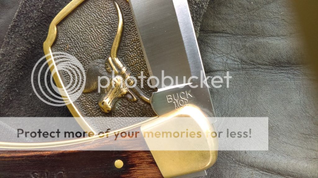

I could never figure out why buck doesn't put a sharpening notch on the 110, something I feel they could really use. It's no big deal though as its so easy to add one if you have a dremel or needle file.
I find that having the notch on a knife really helps with sharpening, and really just completes the look of the buck 110

I like having a sharpening notch so I don't rough up the ricasso area right behind the edge ( something I notice on my knives when it happens ) , and it allows me to still sharpen 100% of my edge if the very edge of my stone is warn or chipped off.
I know it's not for everyone, but I personally like the look and it only took me 10 seconds to add.
Don't care for the look of the pictured one here but I find a "notch" helps me to sharpen evenly to the choil which the Buck grind hampers.
Don't care for the look of the pictured one here but I find a "notch" helps me to sharpen evenly to the chiol which the Buck grind hampers.
Thanks for the compliment on my handy work 😁
It does look a bit trapezoidal in the pic, but not in real life.
Clearly opinions vary but I get it. Thanks for sharing your method and picture. Buck changed the shape of the choil on the 100 series fixed blade knives to achieve the same effect Hickory n steel was after. I believe Buck referred to it as a 'hanging choil'. where the arc or the choil extends into the cutting edge of the blade. On the older 100 series fixed blades the choil ended before the sharpened edge (like on the 110). Picture tomorrow.

I can understand the thought of getting caught in the sharpening notch, but when I cut cordage I normally start my cut about 1/4" - 1/2" forward anyways and rarely cut anything thicker than paracord size. I really didn't like how that little recurve area leading up to the tang looked , but if it wasn't there I might not have put the notch in.

I rather like the look of the notch and for a safe queen it would be fine, for a user knife that notch would drive me crazy. I do often clean up the area where the notch is with file or diamond stone giving the blade a sharp clean shoulder in that area to make sharpening easier. I have a great dislike for the current recurve blade designs that have been popular lately for the same reason.

Funny, how we're all different. I don't see any advantage to a choil when sharpening a 110. I start the square corners of my Sharpmaker rods at the tang and the edge in front of the tang sharpens right up without causing any damage to the tang.

I like the sharpening choils, I cannot stand the shoulder that builds up at the base of the blade without one. When sharpening that shoulder catches the corner of the stone, which in turn lifts the blade off the stone, causing a gap between the blade and the stone until it drops off the corner. This does two things, wears the corner of the stone, and the spot of the blade that is in contact with the stone at the front of the gap.
It never bothered me until I got a diamond stone with its sharp corner. Then I looked and all my natural stones and realized the corners were all rounded. A worn stone ruins a knife, and a knife with that shoulder can ruin a stone IMHO.
I use a cut off wheel in an angle grinder. Just barely kiss the blade. I try to angle it back slightly, which helps keep it from snagging fibers when cutting ropes.
