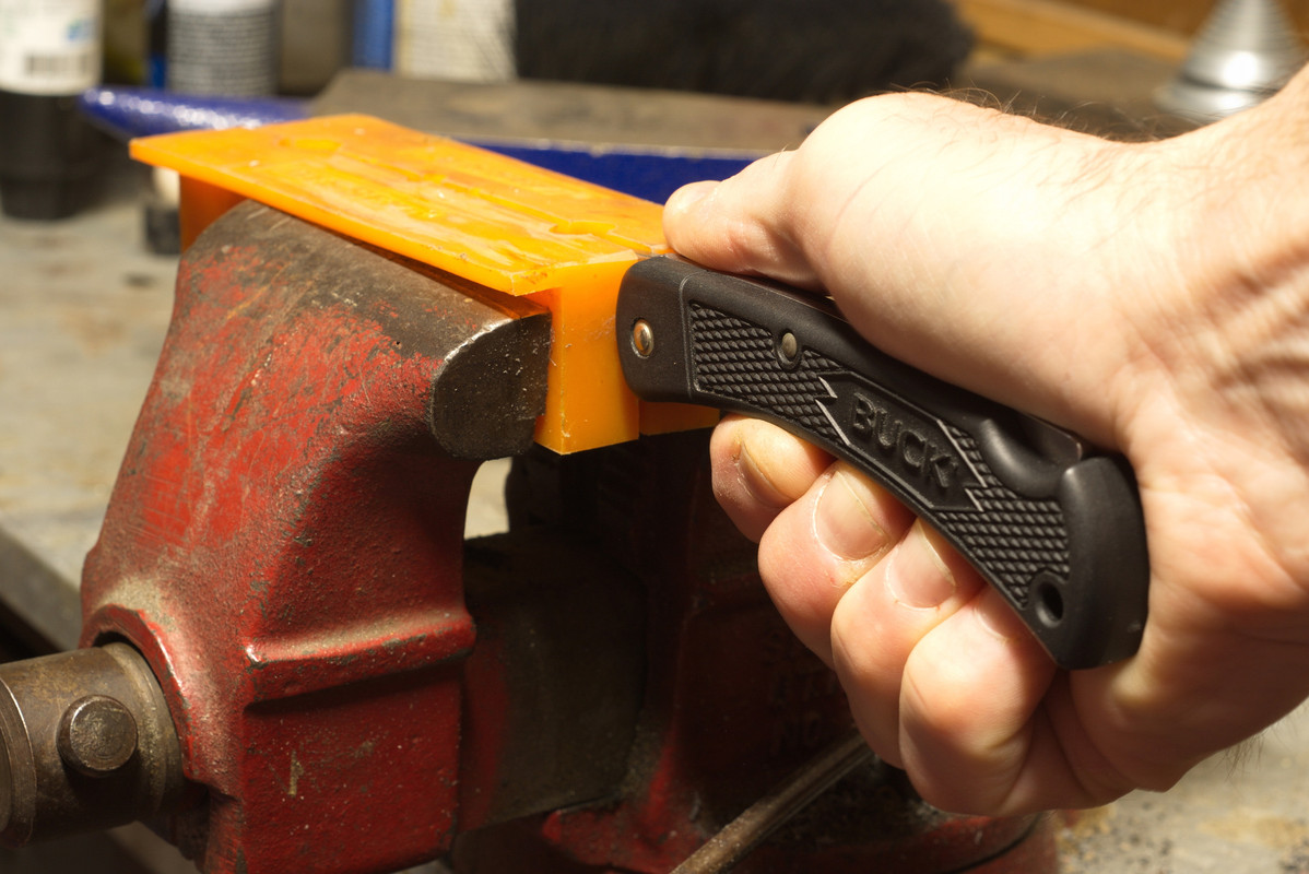

I'll take a stab at it, thinking the blade pivot pin was overtightened at the factory. If it were mine, I would use soft jaws in a vise (or wrap the blade in leather) and clamp down tight, fully to the tang and them move the handle side to side, gently at first, increasing the force trying to spread the rivet until the blade closes and stays closed on its own. Remove and test frequently to prevent too much blade play. This is what old timers called blade "slackening". Another method involves opening the blade half way and striking the tang, angled slightly up on an anvil, effectively spreading the handle apart just enough to free the pinched blade. Both methods involve applying force to the thickest part of the knife and it's very rare to see a 110 blade that has snapped off at the tang.
I might eventually resort to that 'slackening' method, in the vise, if no other avenues of repair are practical for this knife. I'd tried this to a very light degree already, just using some lateral pressure to the blade, applied by hand only. But it'll need a little more than that, as my light effort so far didn't change anything.
