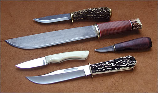

Thank you for sharing the process with me. How many handles have you done before this one?
5 or 6. There may be another stick tang leather handle not in that photo.
The important thing is not to rush towards results.
Enjoy the process. Take your time.
Learn by doing.
Walk away when you hit an impass so you can think of a work around or research a solution.
The carver stag piece at the top was to have a mahogany handle, a scrap from the Steinway piano factory. I was over zealous and shaped the handle down to the tang hole.
Learn by doing.
The big leather handle piece slipped in the clamp and the epoxy dried with the guard, leather and butt cap all 1/2” away from the ricasso.
I walked away (crushed) and researched. Turns out you can soften epoxy in boiling water.
I got it all apart. Had to cut new leather and clean it all up. But the project was saved.

Taking my time with projects is something I've been realizing I have to do recently. I'm realizing some things cannot be rushed if you want a good result and somethings may take hours.
Im assuming the butt-cap to the leather handle is something you made, it looks so professional, along with the entire handle and the other knives as well, those are beautiful pieces. How long would you say you take to do an entire handle on average?

Would you say a beginner would be able to do this and not mess it up badly?
I think it’s an easy project. Everyone has to start somewhere. Even if you ruin it, you don’t like it anyway. Plus it will be a learning experience

Thanks for the kind words!
I really couldn’t tell you how long it takes. I’d work on it when I had time, sometimes more time than others.
I remember doing one over Christmas vacation, so a week? But not a 40 hour week lol.
The leather handled knife has a brass plate / buttcap. The tang comes through it and is peened over it.
Peening works with carbon steel, stainless tends to crumble IME.
Jump in, do a handle, make a sheath.
I knew nothing when I started. Like you, I saw someone else’s cool work and decided to give it a go.
